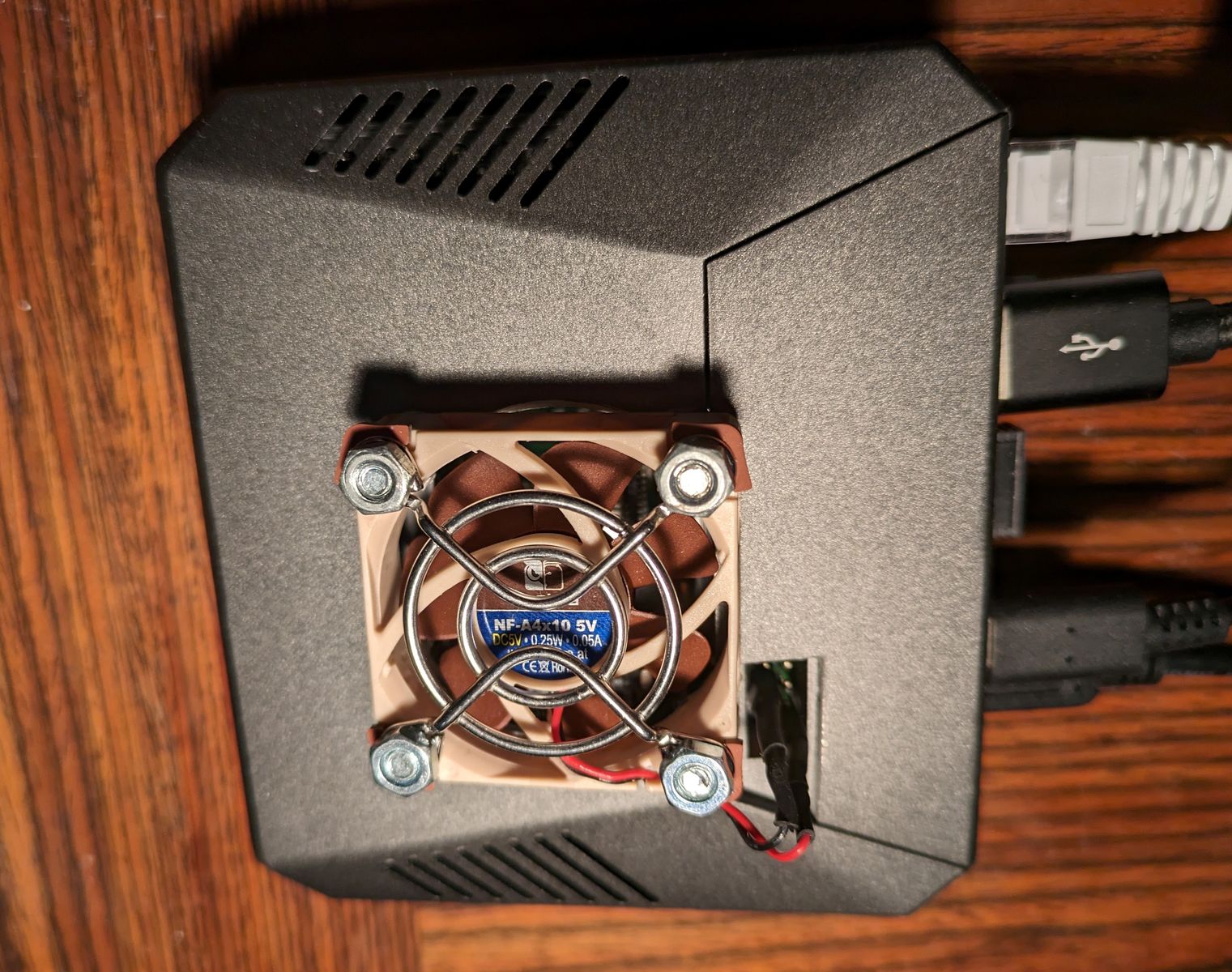

  • The fan in the Argon case is to noisy even at low speeds, i ditched mine and put on a Noctua 40 mm 5V connected to 3,3V GPIO, it spins all the time but its quiet and temp never goes over 40C.
    Can you share details on the fan and your installation job?
