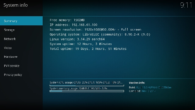

  • LibreELEC 9 beta version for KI Pro based on GDPR-2 LE 1.0.4.1
    LibreELEC-S905.arm-8.90.2-K.img.gz
    LibreELEC-S905.arm-8.90.2-K.tar
    You can use it for other S905/S905X devices and WeTeK Play2. You need only replace dbt.img and add /storage/.config/remote.conf.
    Release Notes:
    - Kodi Leia 18.0-Alpha1 g055f6ee;
    -TVH from repository doesn't work. You have to install service.tvheadend42-9.0.33-607.zip;
    - pvr.hts, pvr.iptvsimple and pvr.vuplus are preinstalled;
    - fixes for smooth hi-bitrate playback (jellyfish-200Mbps);
    - chapter skipping fix;
    - fixes for wrongly reported fps;
    - aspect ratio16:9 is preferred for start playback SD live TV;
    - Samba 4.7.1;
    - fix for audio stall detection
    Sources: GitHub - afl1/LibreELEC.tv at 8.90.2
