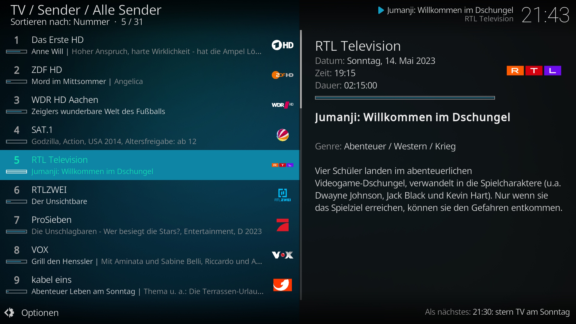

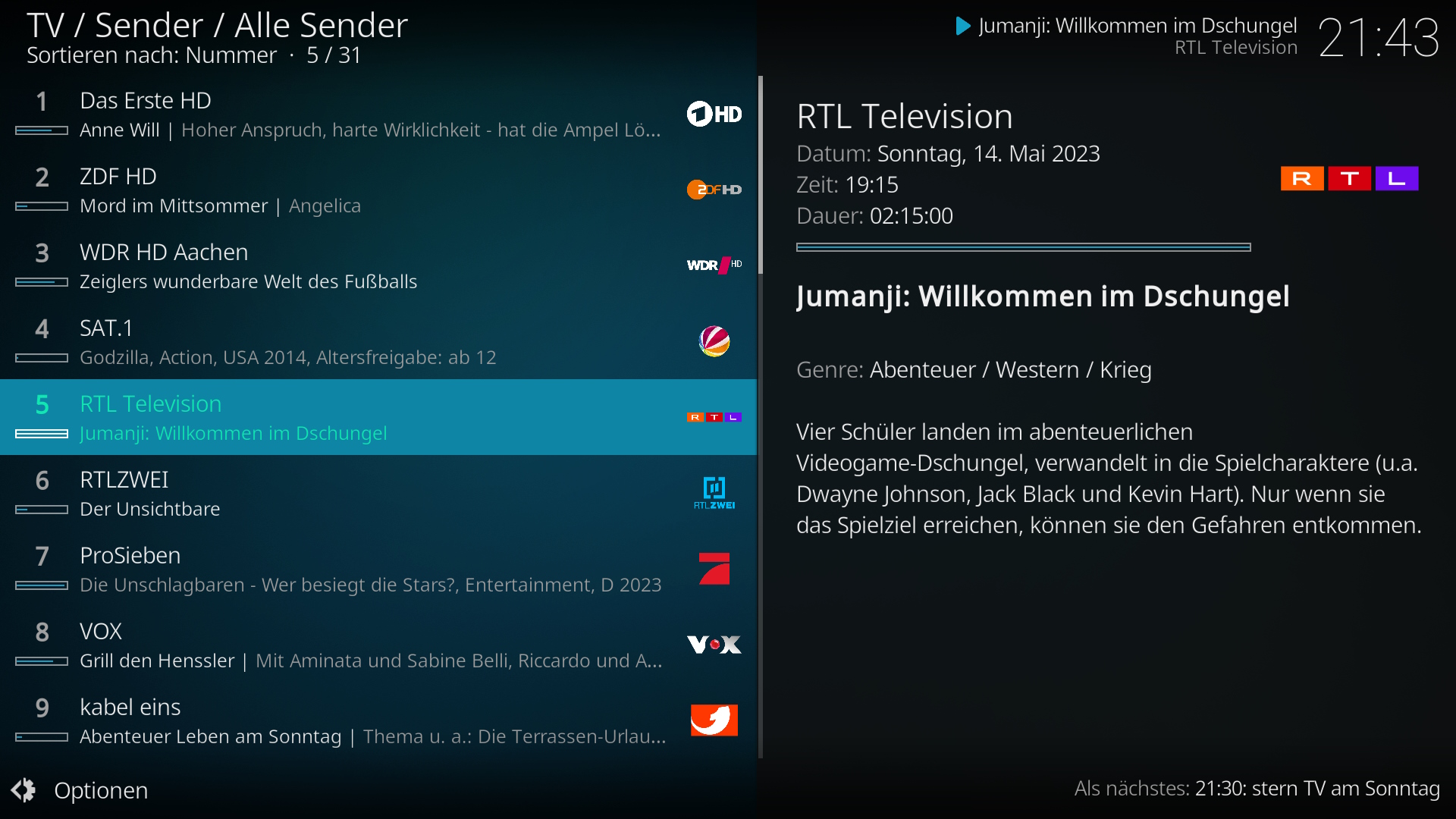

  • Here you can see the program overview and the off-by-one error, cause the movie started at 20:15 and not at 19:15:

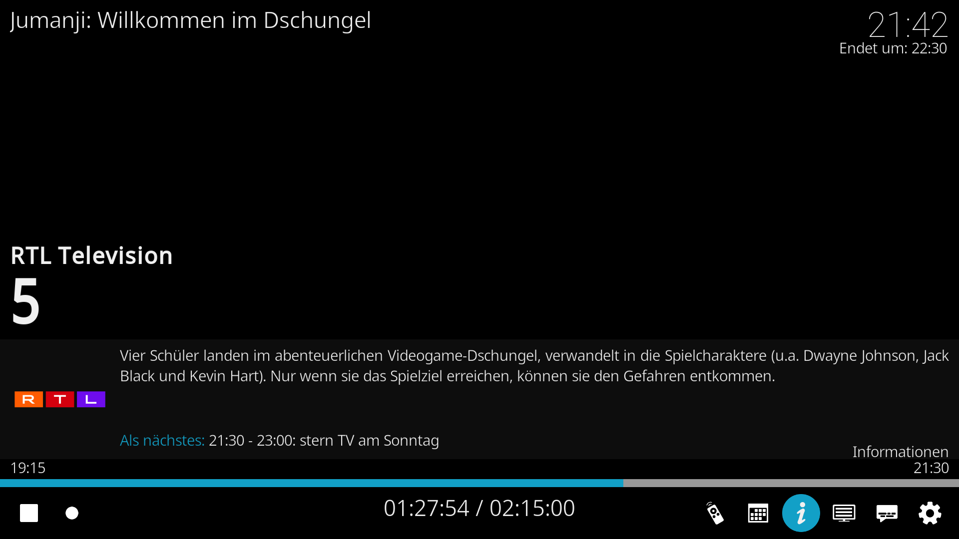

    If we take a look into the program info, when the channel is running it even gets more weird:
    While the time and also the end of the movie in the top right is correct, the information in the text box about the next program is wrong, cause the next show will run at 22:30 and not at 21:30. Also the start and end time at the bottom is wrong, while the relative time is correct again.
  • In general check if the EPG error is in tvheadend backend or in kodi only.
    But without having any tvheadend experience I cannot really comment this.

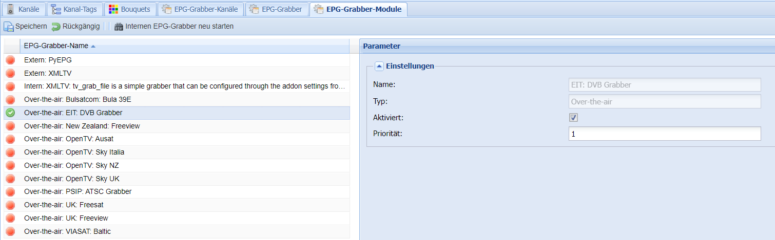

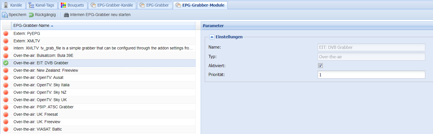

  • The problem is not knowing where you are pulling your EPG from. Once that’s determined that will help to narrow down the problem. It definitely looks like your EPG is reporting GMT time. Are you using TVH built in EPG grabbers or an external EPG source. If using internal TVH grabbers which ones have you enabled.
