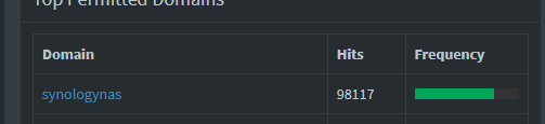

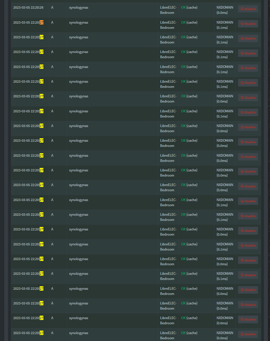

    Since the upgrade to the latest newest version of LE I noticed that my network requests went through the roof. I can see that in Pi-hole otherwise I wouldn't even have noticed it. I have no problems though.
    I use sql library which is stored on my Nas
    As you can see it made 22 requests within the same second.

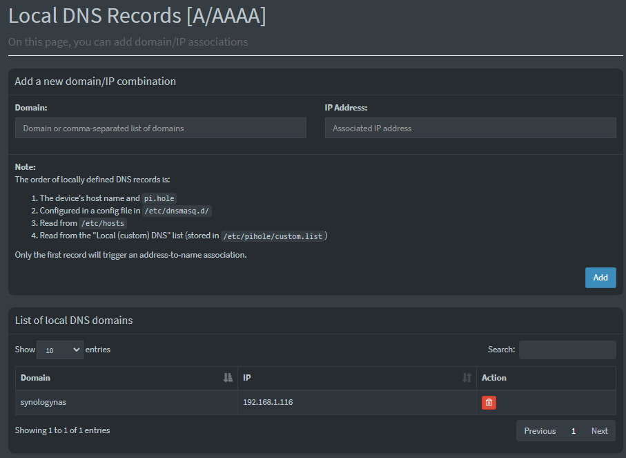

  • The screenshot in your first post is showing that your PiHole received a DNS A (address) request for "synologynas" and responded with NXDOMAIN (no address) - so your PiHole doesn't know anything about a "synologynas" host in your LAN.
    You may want to add your local domain name (eg ".lan") to the source hostname (eg "synologynas.lan") and make sure PiHole resolves the name to the IP correctly.

    It looks like you are right.
    I added it in pihole and don't see those massive requests again. I'm still at work so can't test a lot but will do when I get back.
