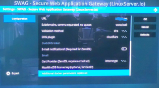

For example SWAG. I know that its settings are located in
/storage/.kodi/userdata/addon_data/docker.linuxserver.swag/settings.xml
and these are parsed to docker as coded in libreelec-addon-repo/docker.linuxserver.swag at master · linuxserver/libreelec-addon-repo (github.com).
I want to play around with swag: add support for additional args by aptalca · Pull Request #92 · linuxserver/libreelec-addon-repo (github.com) but via command line only.
