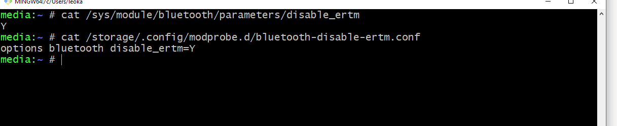

  • Add a persistent module option like this:
    1. echo 'options bluetooth disable_ertm=1' > /storage/.config/modprobe.d/bluetooth-disable-ertm.conf
    The modprobe.d files are loaded at boot time and apply module options.
