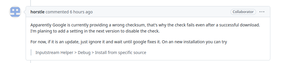

  • There is another addon for installing Widevine, you can google for "SlyGuy Common" and see if that works. It doesn't use ChromeOS images, instead he hosts installs for the library.
    I have installed its repo. It doesn't have any option to install widevine. The easiest way was to go to the input stream helper settings and choose "install from spesific source" under debug.

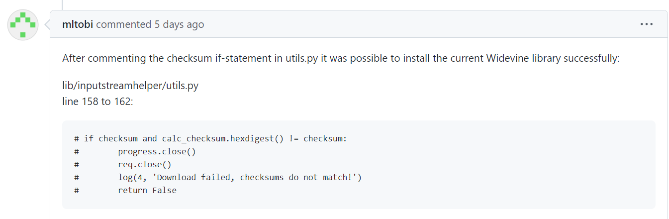

  • The manual ChromeOS download did not work for me.
    mglae : thanks for posting the link
    The below advise in the thread solved the problem with Widevine for me:
    The full path to the file is: ~/.kodi/addons/script.module.inputstreamhelper/lib/inputstreamhelper/utils.py
    Thank you all for your support.
