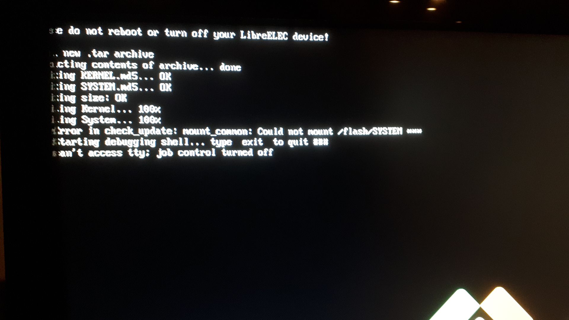

    Then I followed your commands. There were errors on the way, see attached screenshot. Afterwards I still had Libreelec 8 but the settings were reset (which is to be expected due to the "mv" command).

  • Add touch /storage/.update/.nocompat to the update process (before reboot). Your old kernel is not able to mount recent squashfs images.
    Thanks for the log, it helps to avoid the error in the future.
