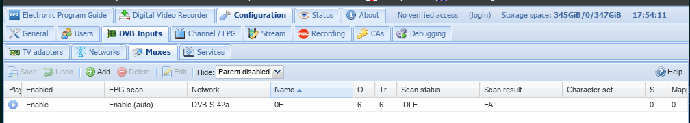

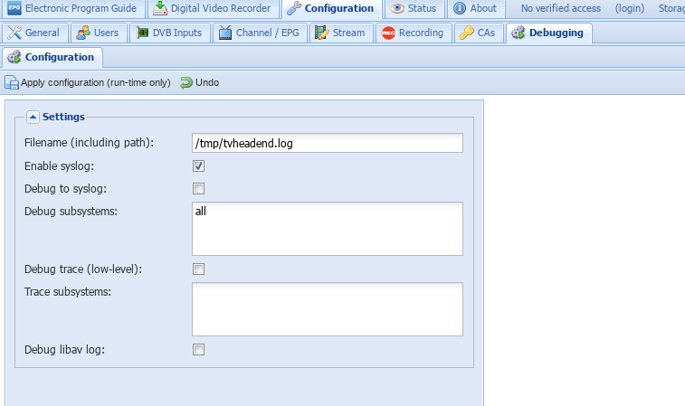

    I set up logging for tvheadend:
    and when trying to scan (IDLE ---me---> active ---auto---> IDLE) the log file contains:
    # cat tvheadend.log
    2023-01-30 21:13:24.447 [ DEBUG]:mpegts: adding mux 0H in DVB-S-42a to scan queue weight 6 flags 4000
    2023-01-30 21:13:24.447 [ DEBUG]:mpegts: 0H in DVB-S-42a - add raw service
    2023-01-30 21:13:24.447 [ DEBUG]:service: 3: 0H in DVB-S-42a si 0x7ffb88004650 STV090x Multistandard #0 : DVB-S #0 weight 0 prio 10 error 0 (OK)
    2023-01-30 21:13:24.447 [ DEBUG]:service: 2: 0H in DVB-S-42a si 0x7ffb88004590 STV090x Multistandard #1 : DVB-S #0 weight 0 prio 10 error 0 (OK)
    2023-01-30 21:13:24.447 [ INFO]:mpegts: 0H in DVB-S-42a - tuning on STV090x Multistandard #1 : DVB-S #0
    2023-01-30 21:13:24.447 [ ERROR]:linuxdvb: STV090x Multistandard #1 : DVB-S #0 - failed to tune [e=Invalid argument]
    2023-01-30 21:13:27.387 [ DEBUG]:settings: saving to /storage/.kodi/userdata/addon_data/service.tvheadend42/input/dvb/networks/dd51acfdf7f5b8a3c0f8ed6d4c146527/muxes/81e3
    ee984f9514758fbddeaf02cbf8a9
    (marking in bold by me)

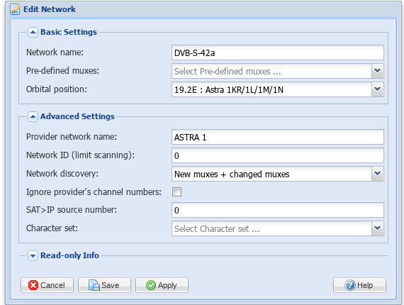

    Looking for the message, I found this:
    https://tvheadend.org/issues/3212
    Then I opened the editor for networks:
    I selected 19.2 E Astra from "Pre-defined muxes" and also in the "Orbital positions". When I reopen this the data above is shown.
    And suddenly the Muxes and Services tabs started filling. Now I have to see if thinks work now but that seemed to be the issue. I am reasonably sure I tried editing this network a few times and deleted/created it. But maybe that was while I had the wrong drivers? Hard to tell by now.

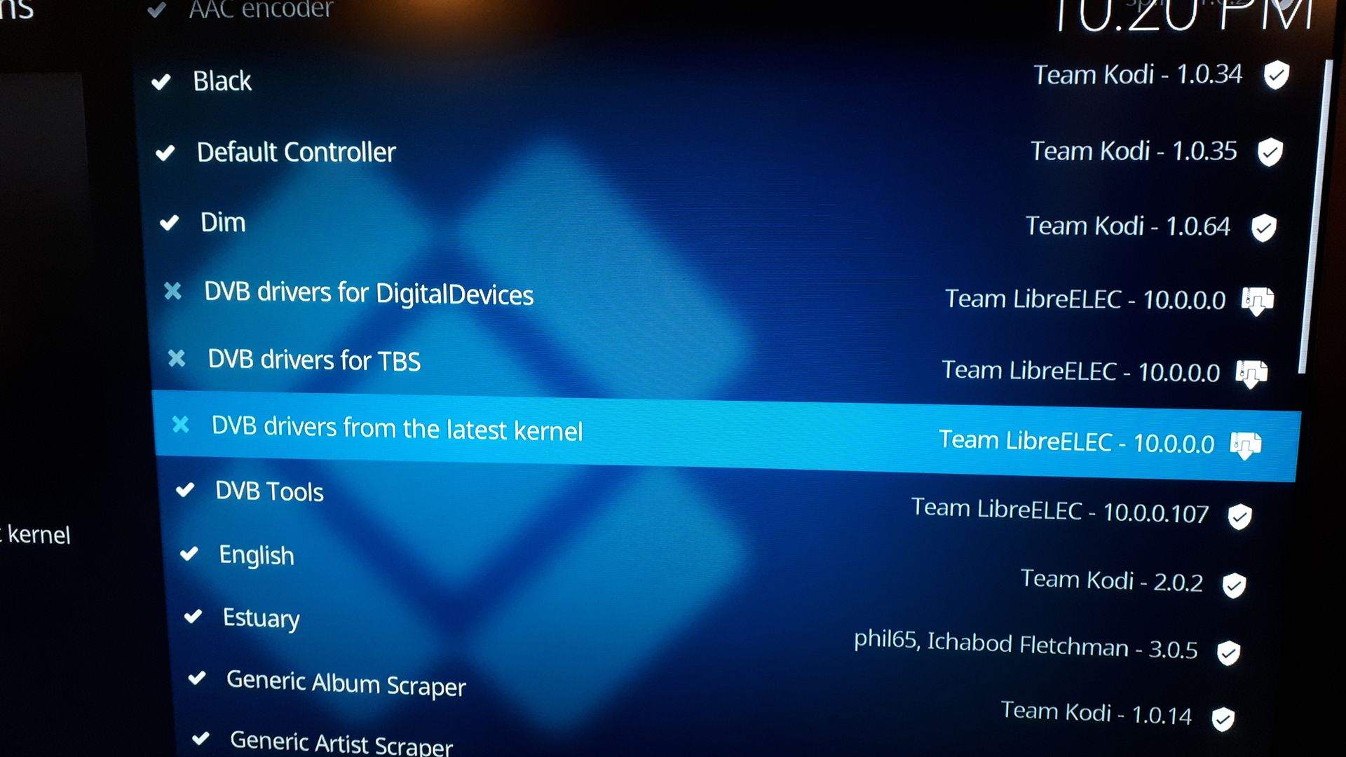

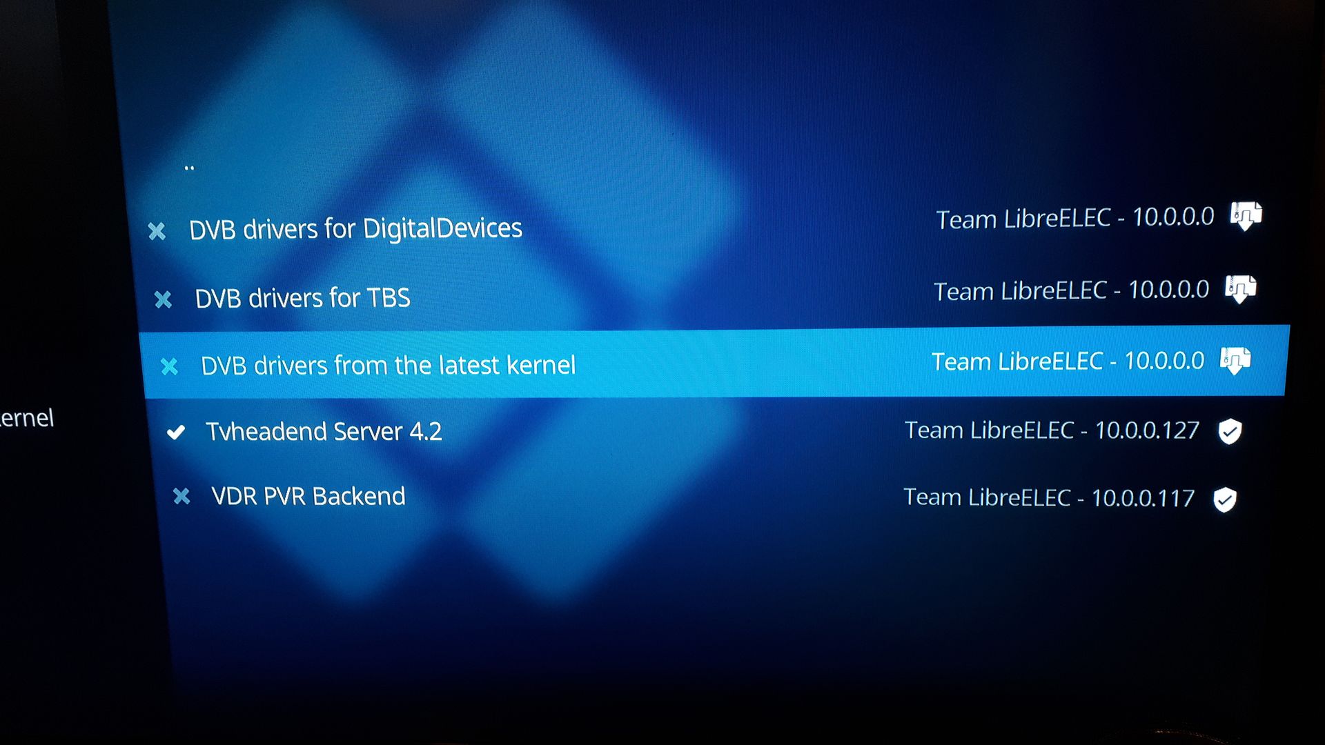

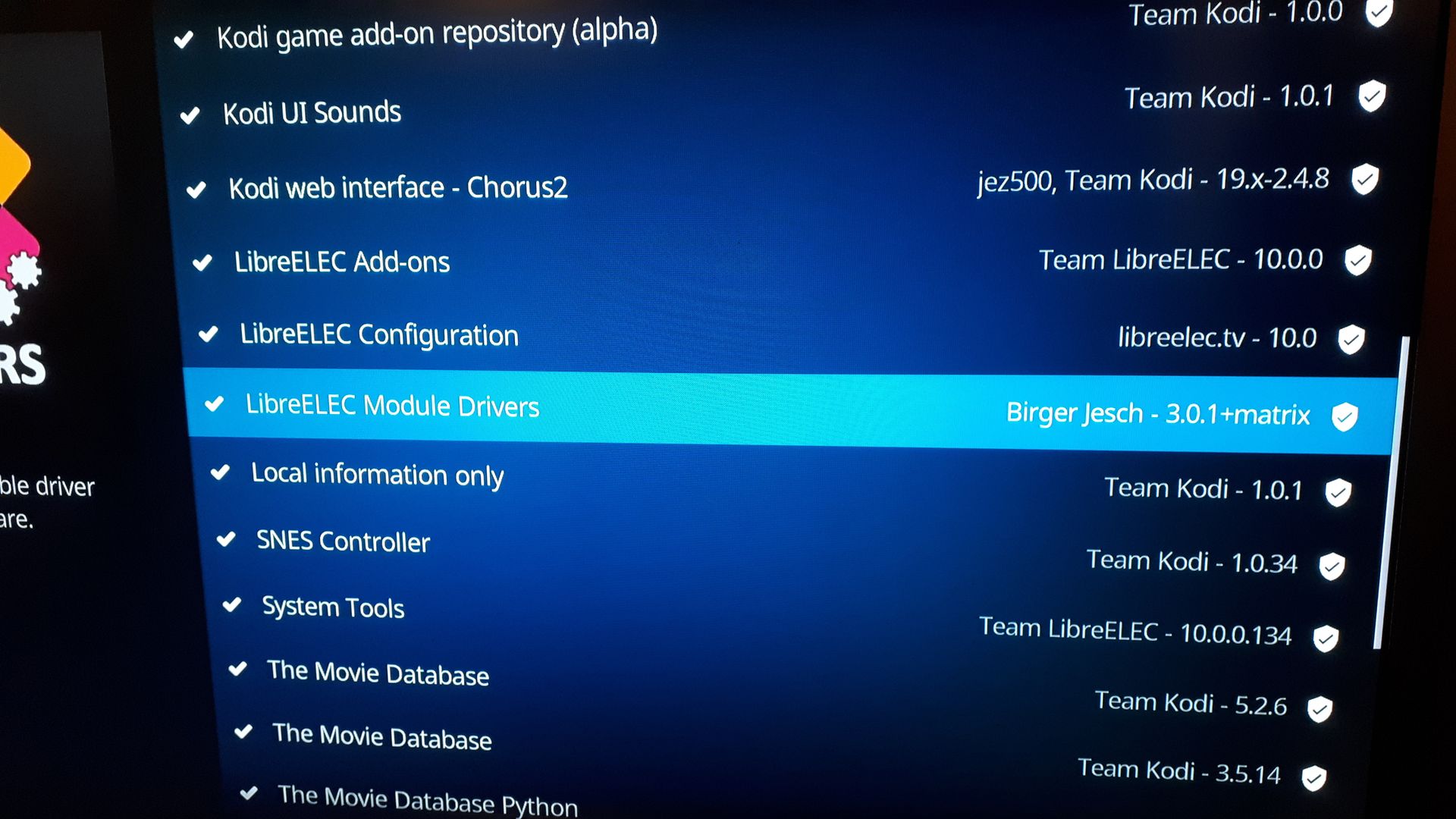

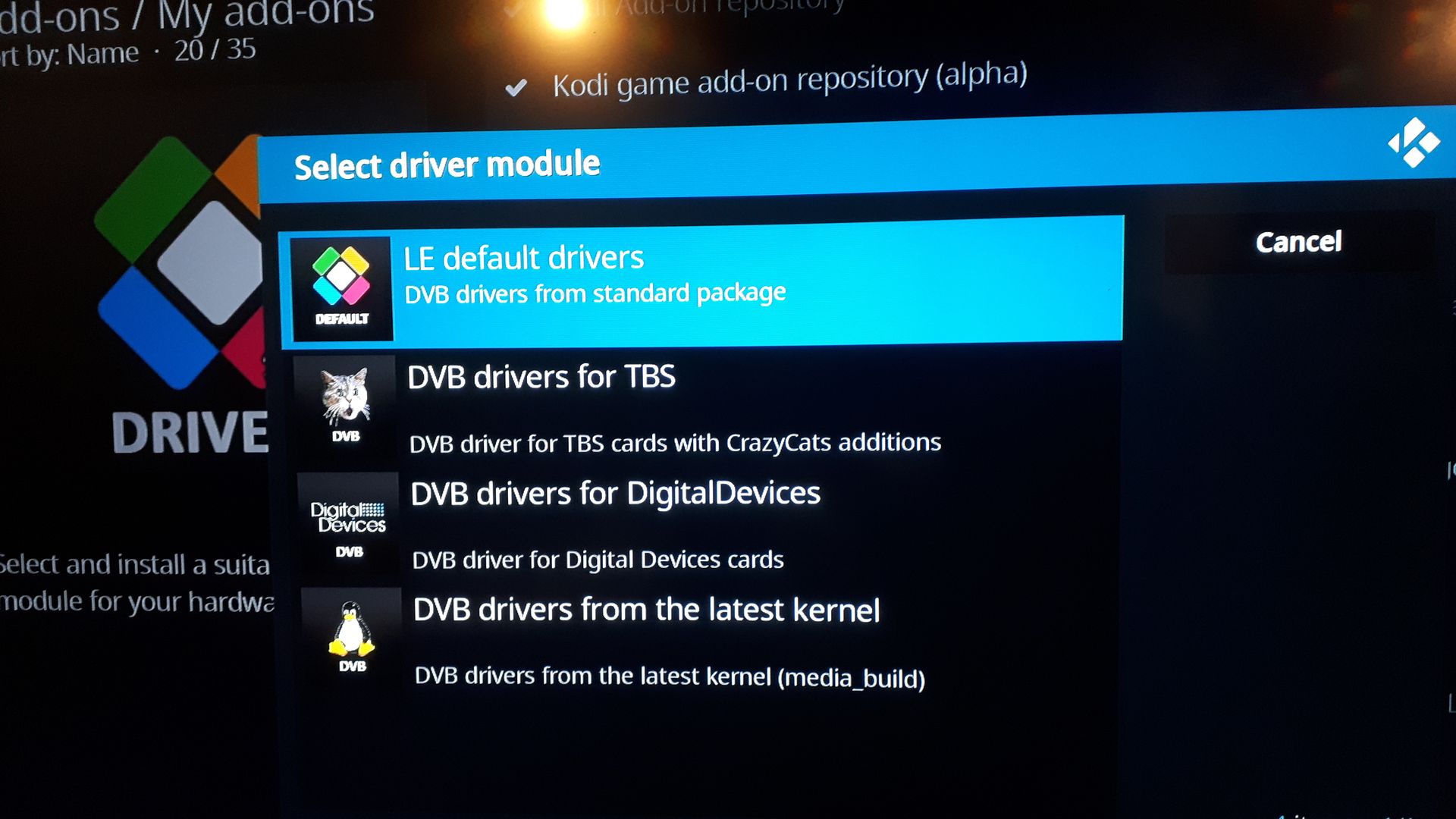

    Thanks for the reply. This did change the driver:
    LibreELEC:
    ~ # modinfo ddbridge
    filename: /lib/modules/5.10.161/kernel/drivers/media/pci/ddbridge/ddbridge.ko
    version: 0.9.33-integrated
    license: GPL v2
    author: Ralph and Marcus Metzler, Metzler Brothers Systementwicklung GbR
    description: Digital Devices PCIe Bridge
    srcversion: 26A5F203B39FDCD7E5CC63E
    But the results with w_scan and tvheadend stay the same.
    Update: Attached screenshots of what I selected now. Note that I am asked to reboot reach time I pick "LE default drivers". Don't know if that is normal or if that is an indication that something is not saved.

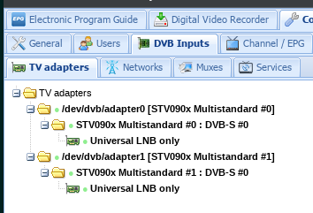

    Hi,
    I have a Digital Devices Cine S2 V6 dual-tuner DVB-S card installed on a custom built PC with Libreelec v10.0.0.4. It should work out-of-the-box but I cannot find any channels using TVHeadend.
    Here is what works:
    a) The PCI card is recognized. lscpi -v gives (only relevant part shown):

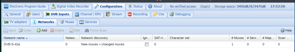

    c) TVHeadend does see the card:forum.libreelec.tv/core/attachment/9038/
    d) Network is configured:
    forum.libreelec.tv/core/attachment/9040/

    Now for the part that is not working:
    g) However, the scan with TVHeadend fails:
    forum.libreelec.tv/core/attachment/9041/

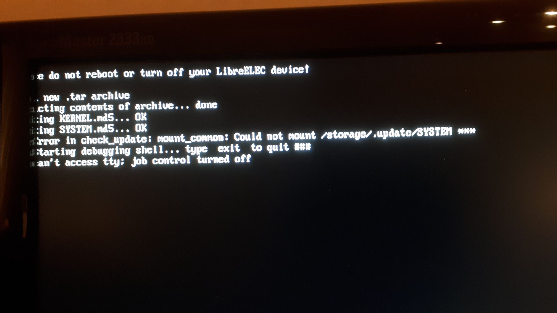

    First I expanded the /boot partition, it was ~518 MB, now its ~700 MB. This didn't change things.
    Then I followed your commands. There were errors on the way, see attached screenshot. Afterwards I still had Libreelec 8 but the settings were reset (which is to be expected due to the "mv" command).
    I am OK to repartition the system, there is nothing that needs to stay. A backup of all important data is ready. Is there a guide? Or should I simply clear the partition table, e.g. to an empty GPT one?

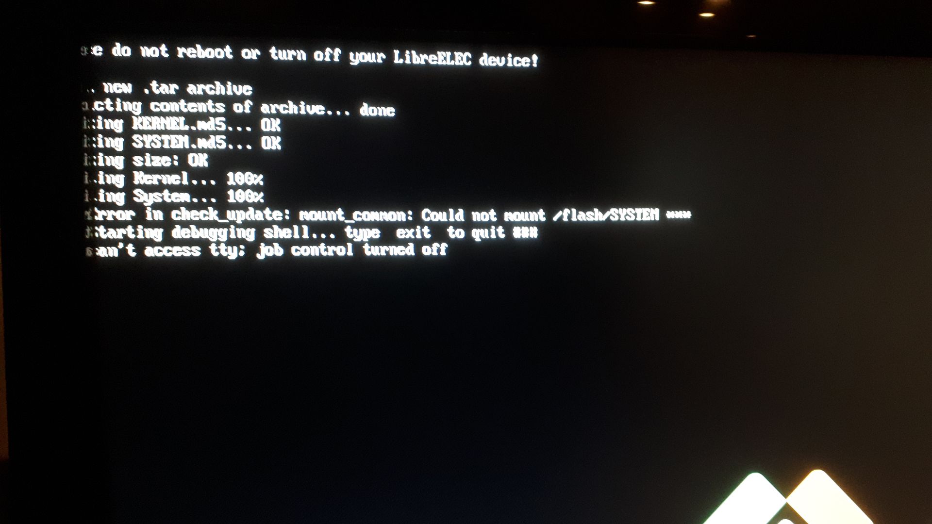

    Hello everybody,
    I'm trying to do a fresh install of my HTPC. The system is based on a i7-6700T (Skylake) and uses a Samsung SSD. It currently runs Libreelec 8.5.2.
    Now I want to go for a fresh install with the latest LibreElec but I am unable to install. I created an USB-stick with the installer and no errors were shown. When I boot from the device, the installer shows up. But, just as in this thread the installer reports that no devices were found. I assume it refers to the device to install upon.
    The HTPC is functional, I can boot into it without the USB device.
    I used the installer to write a log file, which is attached here.
    My guess is that some settings regarding secure boot or UEFI are incorrect.
    Does anybody have a hint for me how to proceed?
