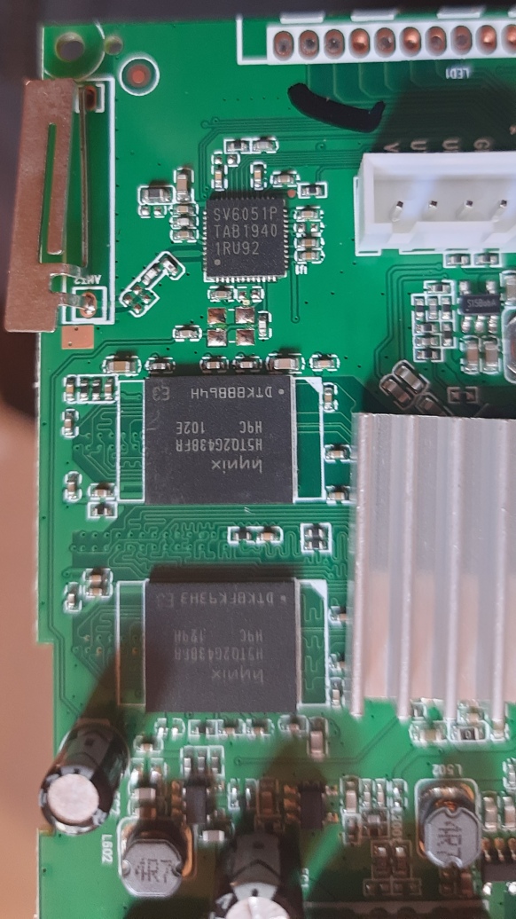

Hi ilmich i have a box called "OneTV Lite". In its original Android FW the CPU is called RK3229. And also it says RK30SDK rk322x_box in the Android info. I opened it and found wifi sv6051p and flash is emmc sandisk sdinbdg4-8. I am not sure if RAM is 1Gb or 2Gb.

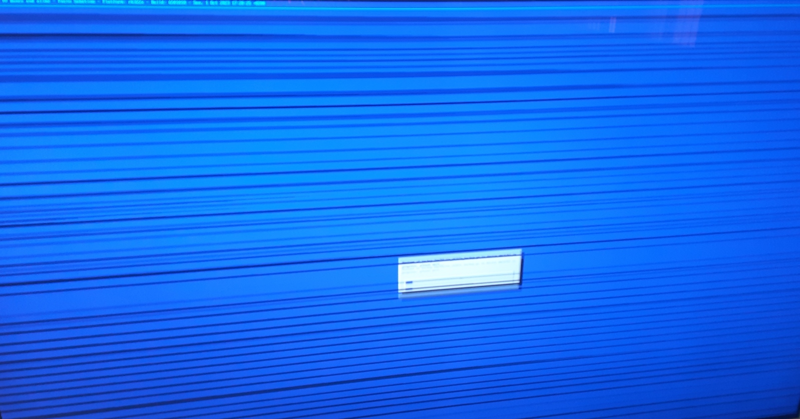

nope, it must be software issue because i reflashed my FW backup and played a .mp4 file from sd card and no such graphics glitches..

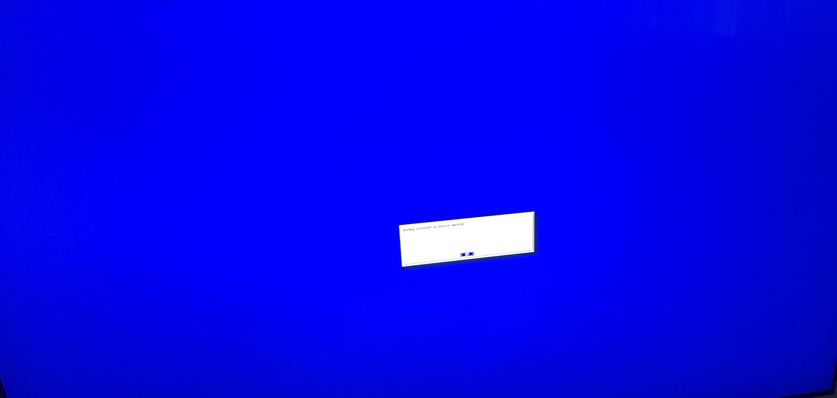

i made pictures while multitool was flashing my backup, you see the image jumps and has black bars running all over the place while its writing the data.
When its finished an there is no activity the image is crisp and clear.
i understand this are multitool images but the same happens while booting ilmichs libreelec build. (If necessary i could take pictures of that aswell, but its the same effect).
It never does any harm trying a different HDMI cable. You’ll be amazed how many problems it has solved when you least expect it too.

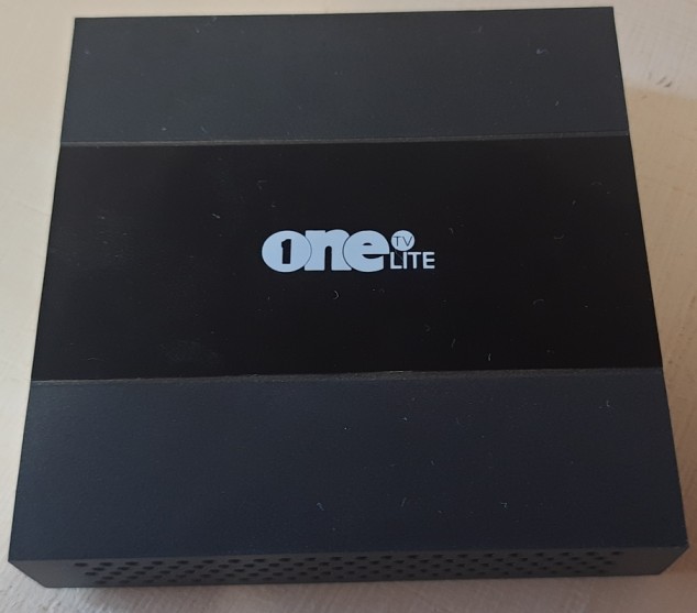

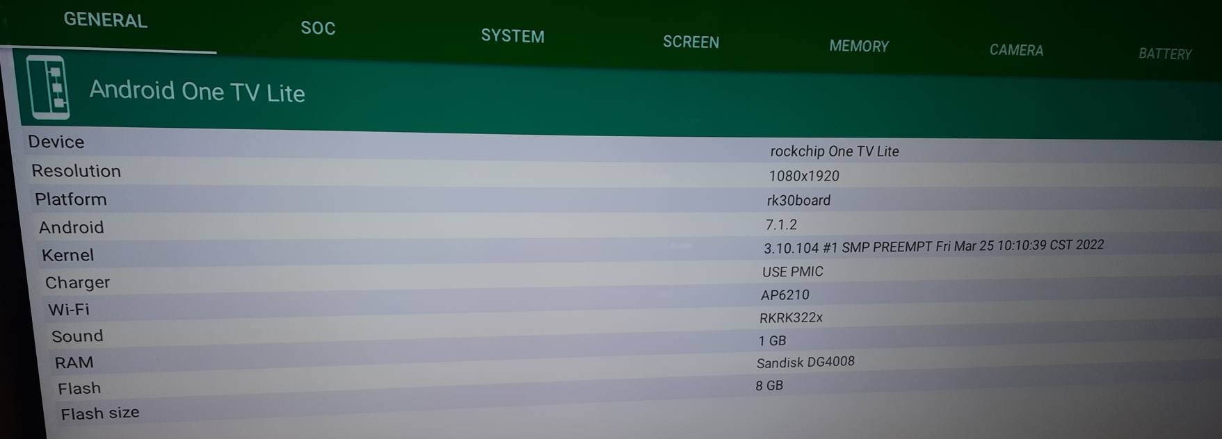

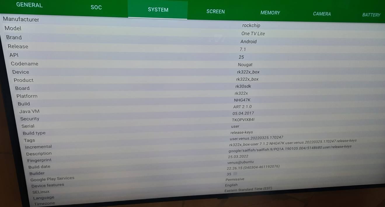

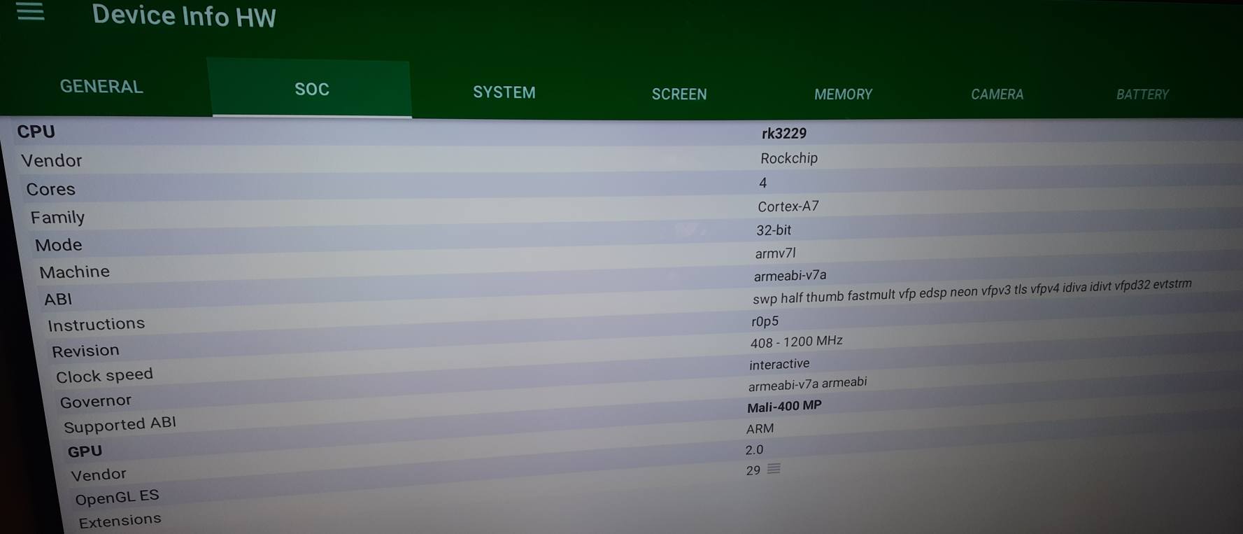

Hi ilmich
here are the pictures of the box and board:
the pcb marking reads: MP5_RK3229_8723_ZZQ-V1.1 2020-04-08
There is a preinstalled app "Device Info HW", strangely this app shows wifi AP6210
i also ran AIDA64 and this is the report file: report-1969-12-31-19-19-02.txt
i sent you the original firmware download link in private
