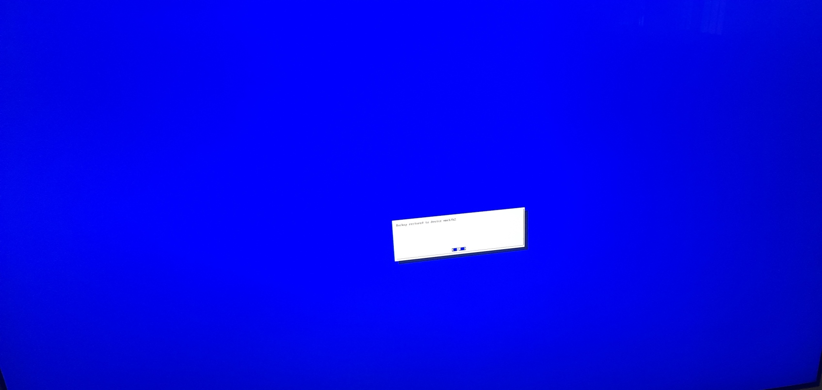

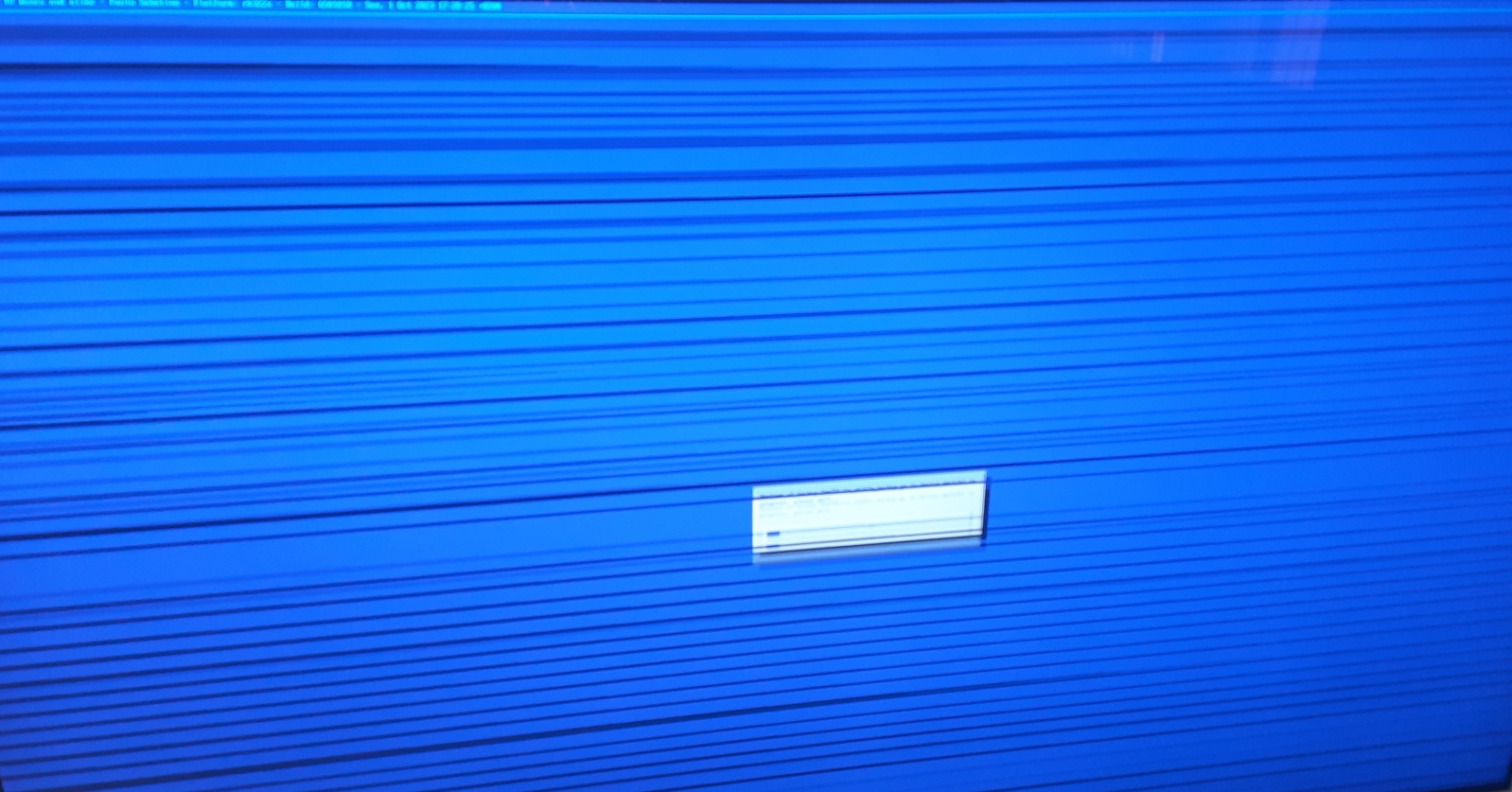

    i made pictures while multitool was flashing my backup, you see the image jumps and has black bars running all over the place while its writing the data.
    When its finished an there is no activity the image is crisp and clear.
    i understand this are multitool images but the same happens while booting ilmichs libreelec build. (If necessary i could take pictures of that aswell, but its the same effect).

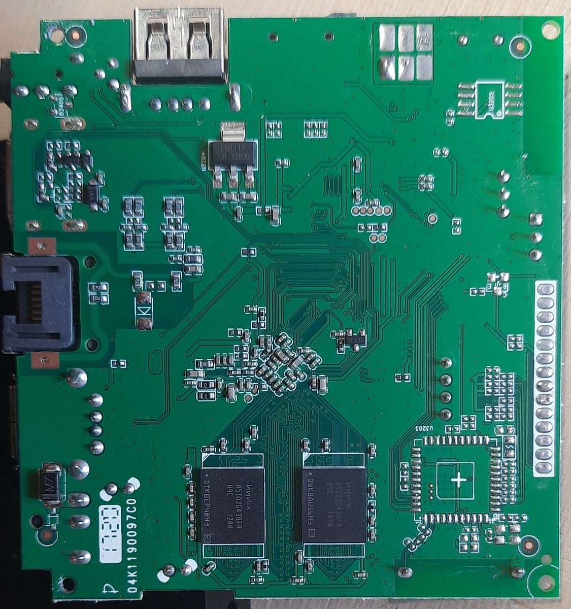

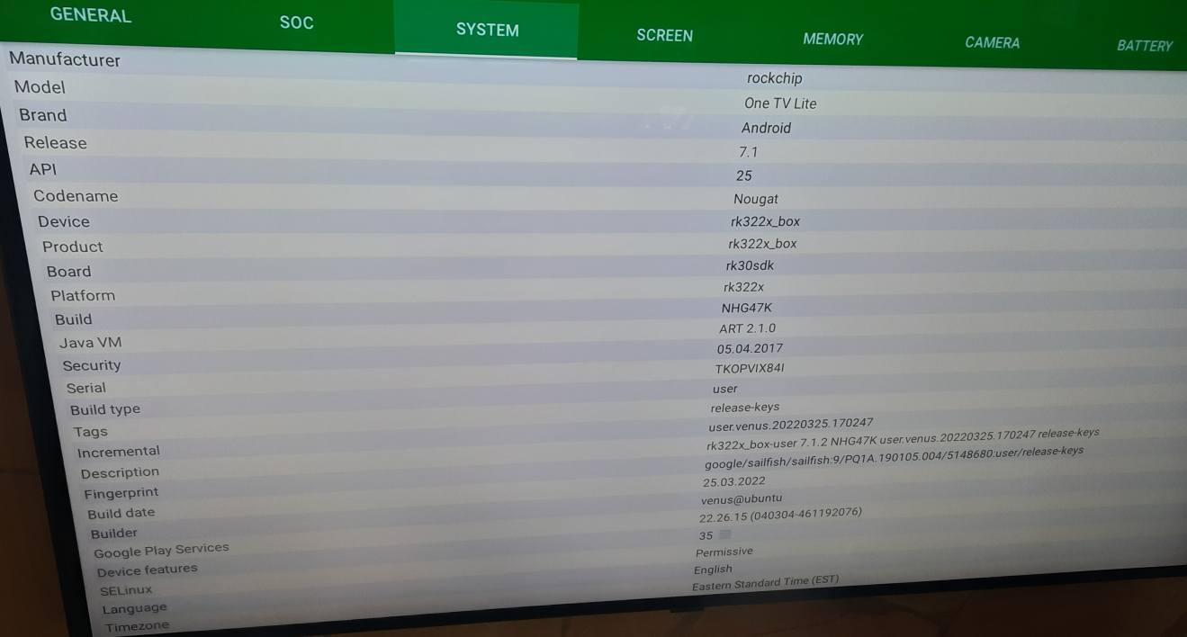

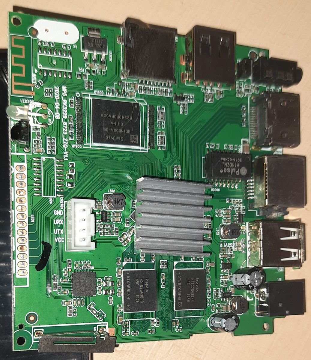

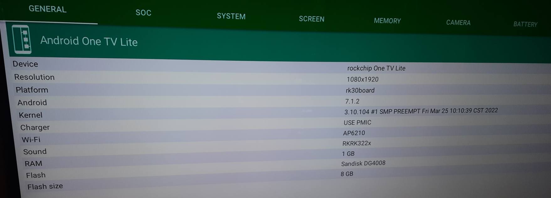

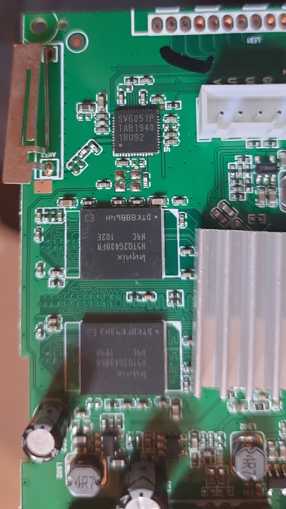

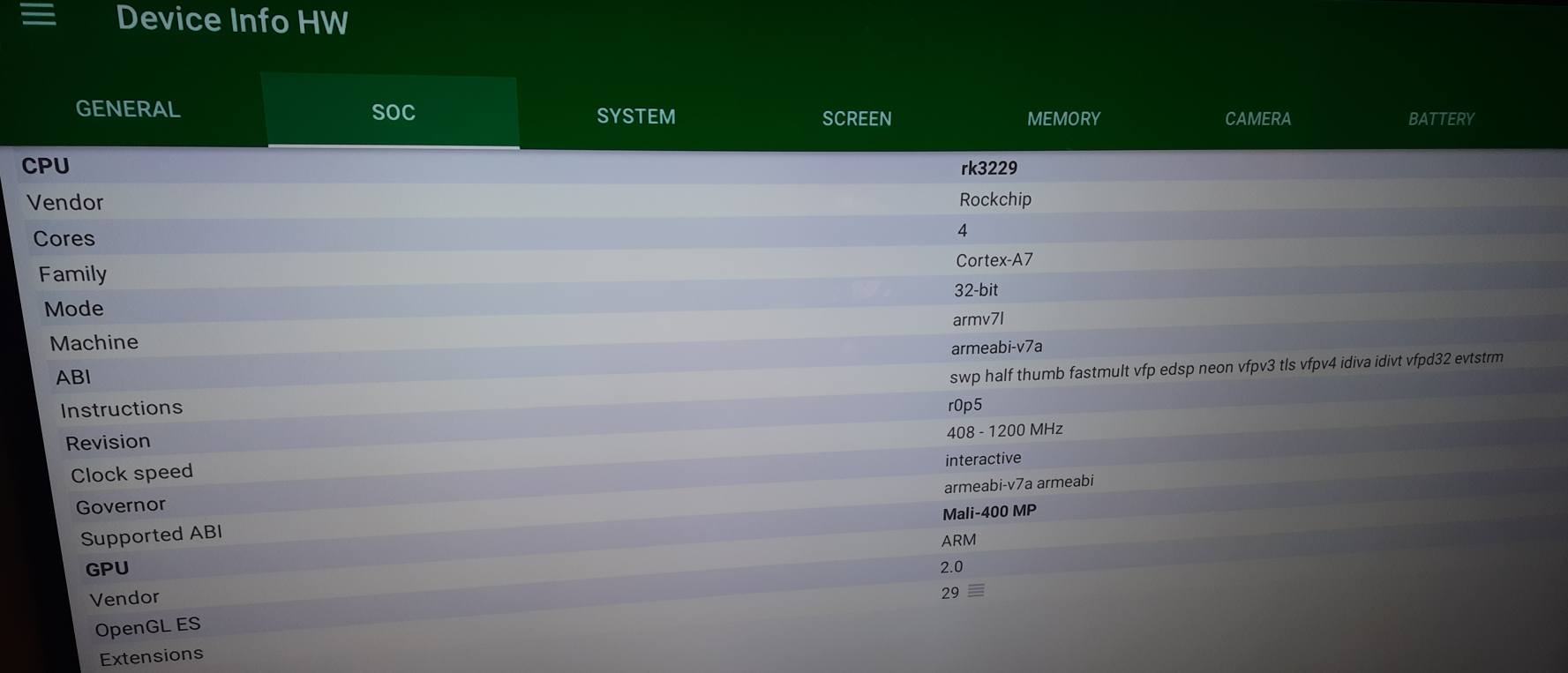

    Hi ilmich i have a box called "OneTV Lite". In its original Android FW the CPU is called RK3229. And also it says RK30SDK rk322x_box in the Android info. I opened it and found wifi sv6051p and flash is emmc sandisk sdinbdg4-8. I am not sure if RAM is 1Gb or 2Gb.
    The box starts multitool and latest compiled armbian (for rk322x) from SD Card. Altough it has a weird graphics glitch (flicker and black bars in the picture) that seems to happen only during sdcard data transfer. As soon as everything is loaded the picture is perfect.
    I tried your latest libreelec 10 build and it doesn't boot with any of your dtb files. Then i started to play around with the device trees and copied some parts from the dtb that comes with multitool. Now i can boot your libreelec build from SD, with the same graphics glitch. Also the glitch dissapears as soon as Kodi finished loading i can navigate trough menus normally. Now i want to ask for your help to create the right dtb for my box. Remote doesn't work and the wifi is not recognised, i tried to copy the wifi node from another dtb with no luck.
