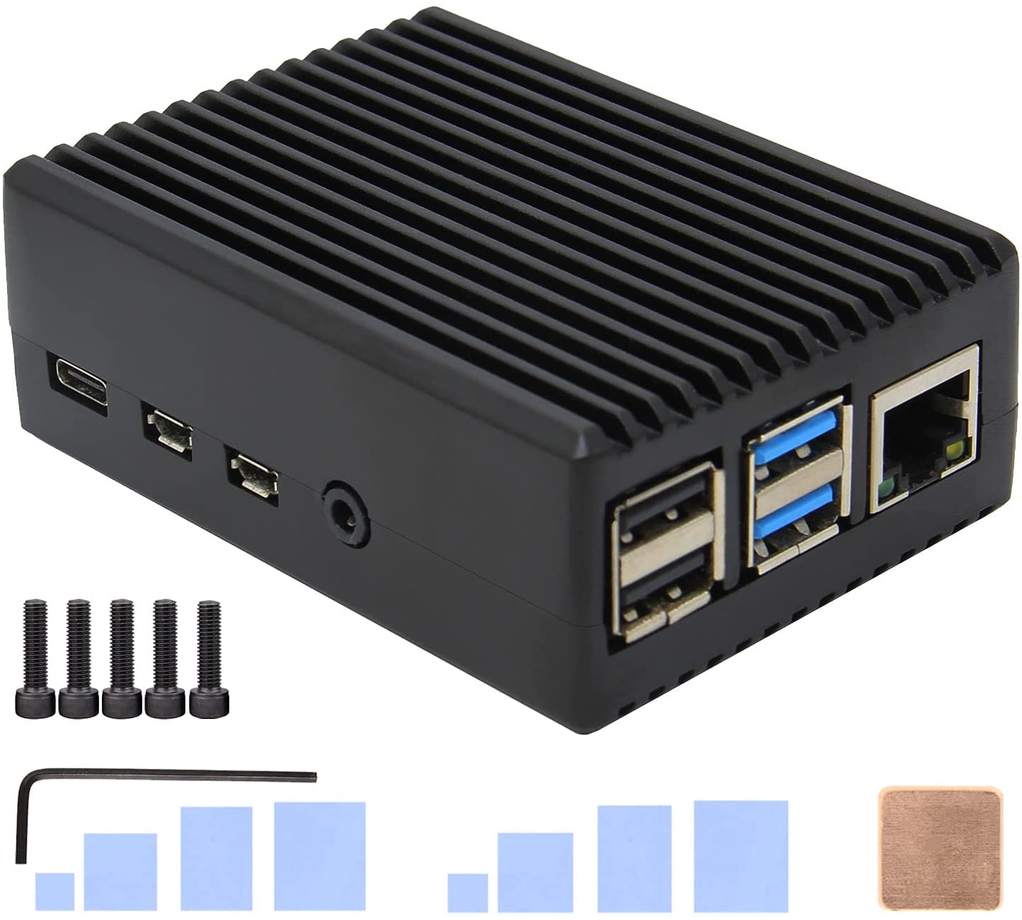

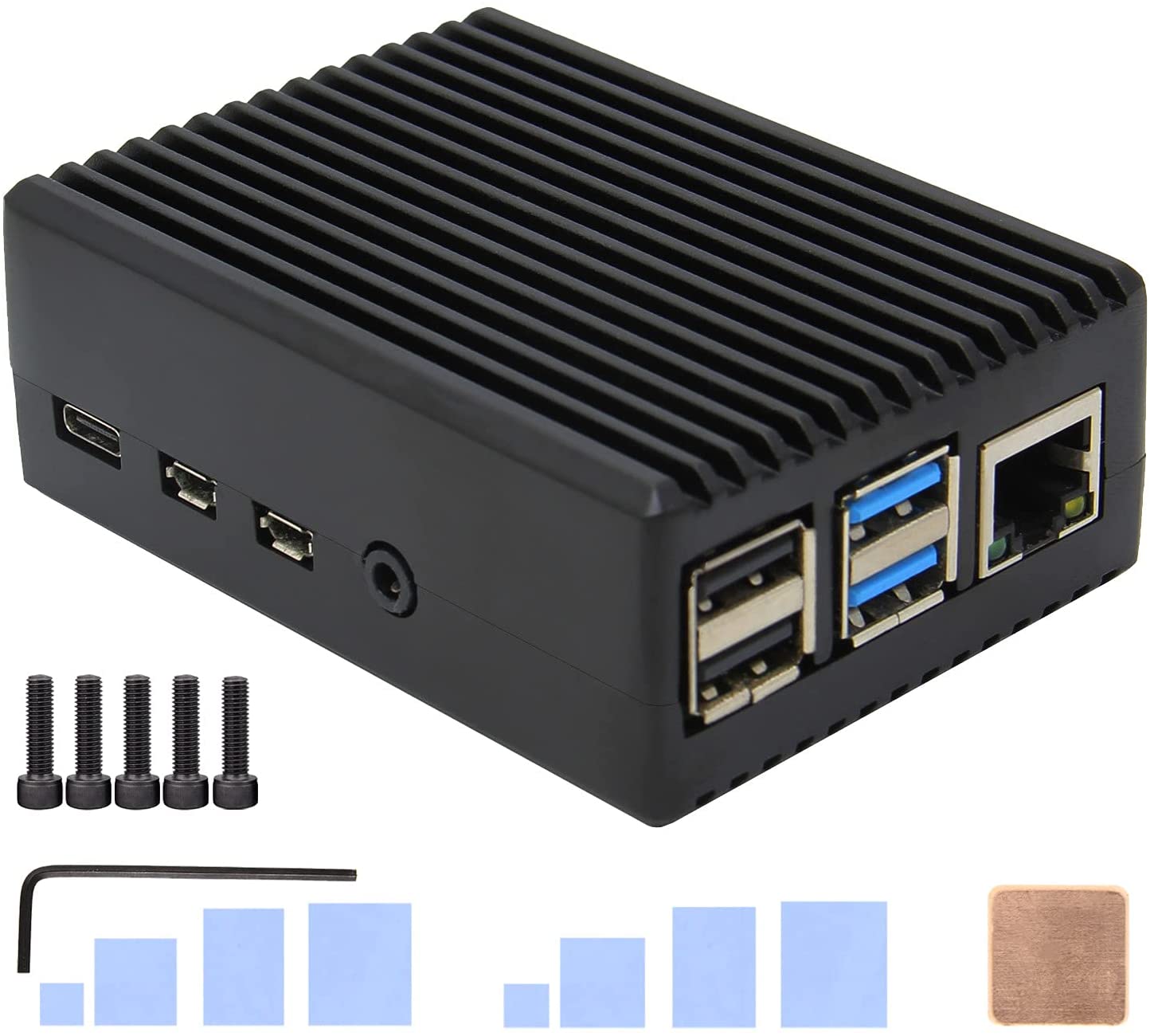

I use the "raspberry pi 4 aluminum alloy case" from eBay which is fairly cheap and looks like great as it turns the PI into a headsink.
Works really well too. I have my PI4 running 24/7 and it sits at around 44.8'C and 46.2'C

I recently changed the default plastic case to a Geekworm Raspberry Pi 4 Aluminum Case
It dropped temperatures during 4k HDR playback to around 40 degrees celsius whether before it would reach > 70 degrees.
Highly recommended.
