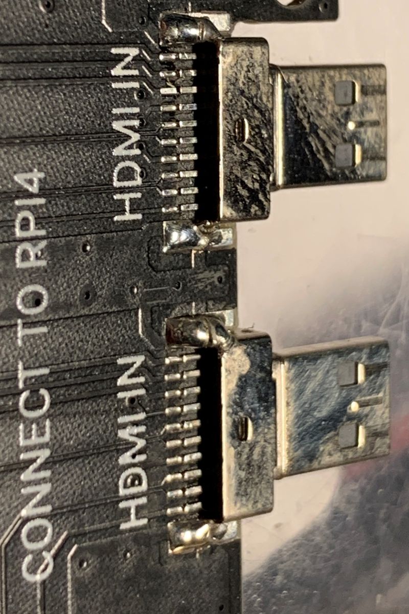

  • The answer to your problem is as simple as it is frustrating: Your Argon One board has poorly made solder joints between the board and the HDMI jacks and connectors.
    I had the same problem and was sent a new board by the manufacturer. I then ordered a second case from the same distributor, which had exactly the same problems with CEC as the first board.
    After I re-soldered the solder connections on both defective boards, CEC worked like a charm.
    Take a look under a magnifying glass and good light at the connections between the Micro-HDMI connectors and the tracks of the board.
    Another problem is the lack of Python 3 support in the script software which causes problems with fan and remote control when using the new version of libreelec (10). It's a shame that such a great case is accompanied by such poor support.

  • Weizen, I am having similar issue and I spoke with Argon40 and they are sending me a replacement board. Did that resolve the issue for you or did you have to solder points on that one as well.
    The replacement board arrived a week after my complaint and it worked well.

  • FYI, I received the new card for one of my Argon One cases and it works as expected on 2 of my TVs. On the third TV I had to set the resolution in cmdline.txt to 720p for it to work.
