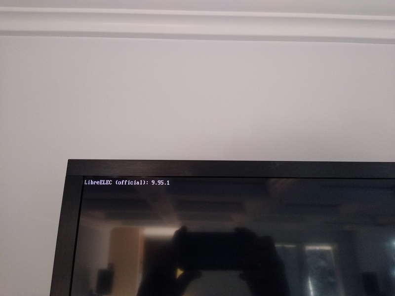

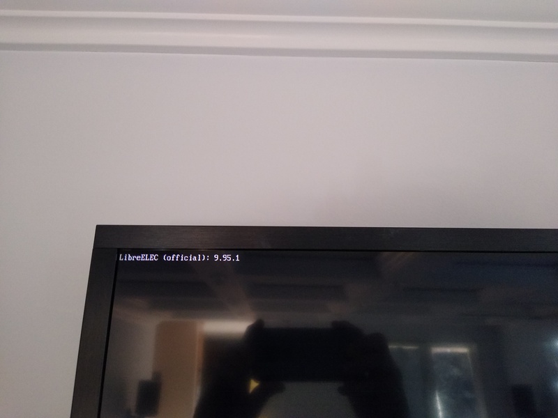

  • Yes.
    I also tried switching the HDMI cable to the other port, as well as creating an EDID file for both monitors.
    Please understand how much I appreciate the help. I've never dug this deep into LE so I'm ignorant of the details but it's nice to learn more about the system.
    Without this change, the screen stays black. With this change, it shows the LE version and hangs. So, it is one step closer to working.

  • I don t own a Rpi 4 yet but your issue might easily be an unsupported resolution the rpi is trying to change to on boot as no monitor is detected...can you try to whitelist some commonly used resolutions like 1920x1080 60hz in the video settings and try to reboot again
  • Da Flex no. The old hdmi_xxx config.txt options no longer have any effect on LE 10. We are finally using open source linux drivers (drm) now. drm.edid_firmware= and video= kernel command line options are the way to go now (like on all other linux systems).
    so long,
    Hias
