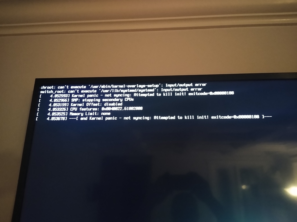

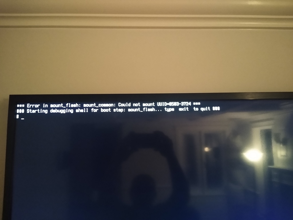

    Second image is a USB flash drive. First image is an SSD. Both v10.0.2.
    Will not boot from SD card.

    I've been running LE for many years and LE on an rPi for a couple. 10.0.2 was working fine until last night when I disconnected the rPi to re-arrange the livingroom. The case is an Argon One M.2 with 120 GB SSD.
    On reconnect, it wouldn't boot. Tried a bunch of times, re-installed the boot sector. Still won't work.
    Tried 3 other rPi, for a total of 4. None working.
    Have tried two different rPi on versions 10.0.1, 10.0.0, 9.2.8 (the oldest one on the DL site)
    "chroot: can't execute '/usr/sbin/kernel-overlays-setup'
    Flashed from Manjaro Linux using SUSE Studio Imagewriter and USBImager. Your tool for Windows will not image an SSD.
    Every one of these systems will boot up fine with a Moode Audio image. No way I had 4 systems that were all working all die at exactly the same time, particularly when they all work with Moode.

    Found a USB stick. Installed it using the LE USB-SD Creator.
    Won't boot, either. Different error, though.
