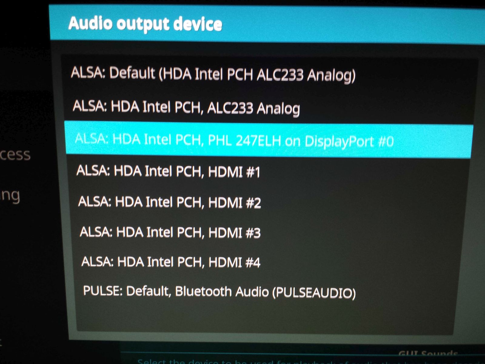

    i'm running an 8i3BEH (also a "Bean Canyon" with lower CPU) and my sound is routed through an Philips Monitor (not an TV Monitor, Typ: see photo)) via HDMI and further to an 2.1 speaker system via headphone out (Monitor)
    I haven't had any problems you described nor with LE 9.2.6 neither nightly.
    attaching photo (sound setting in LE, Bios sound settings)

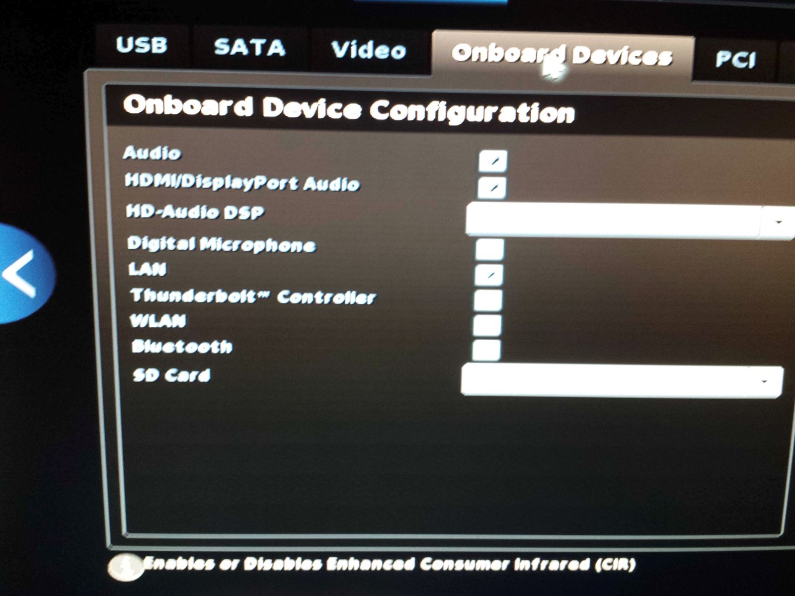

  • BIOS Update done, settings regarding HTMI Ports are set to both, video and sound. DSP is enabled in Bios Onboard device settings.
    No changes regarding problem.

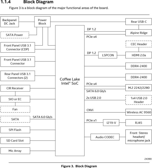

    it seems wise to install the intel driver's for the NUC under windows (at least chipset, graphic), too.
    a somehow damaged flash could lead to an damage LSPCON (see photo).
    I wouldn't risk it !
