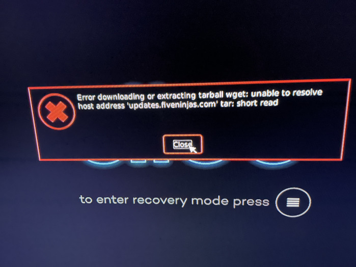

    Hi, i wanna reset my hole Slice. I entered the Recovery mode and wanted a clean System. But then this Message appears. Is there no "local" reset possible the orig. ninjas website is probably offline.
    Or Maybe I can install the latest LibreELEC-Slice.arm-9.2.6.img.gz "directly" via an USB-Stick with FAT formatted?^^

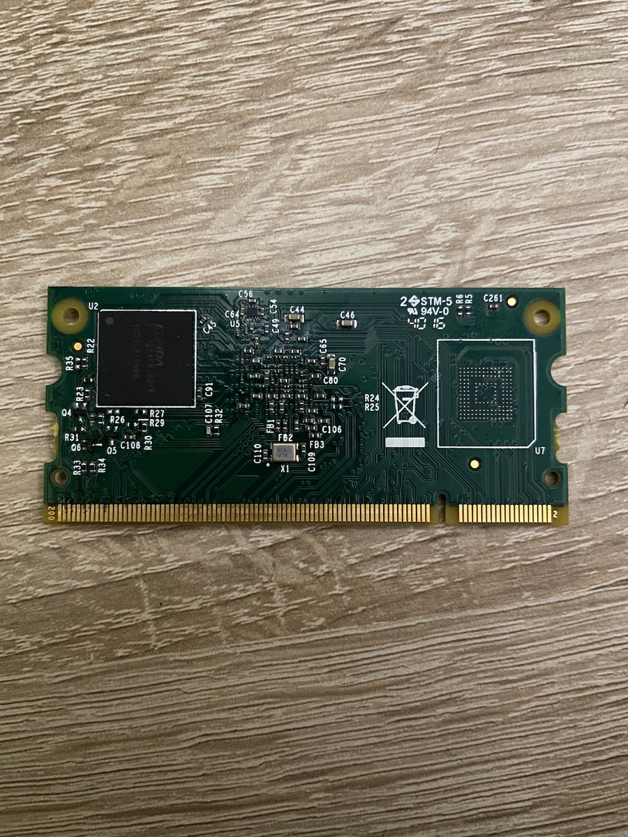

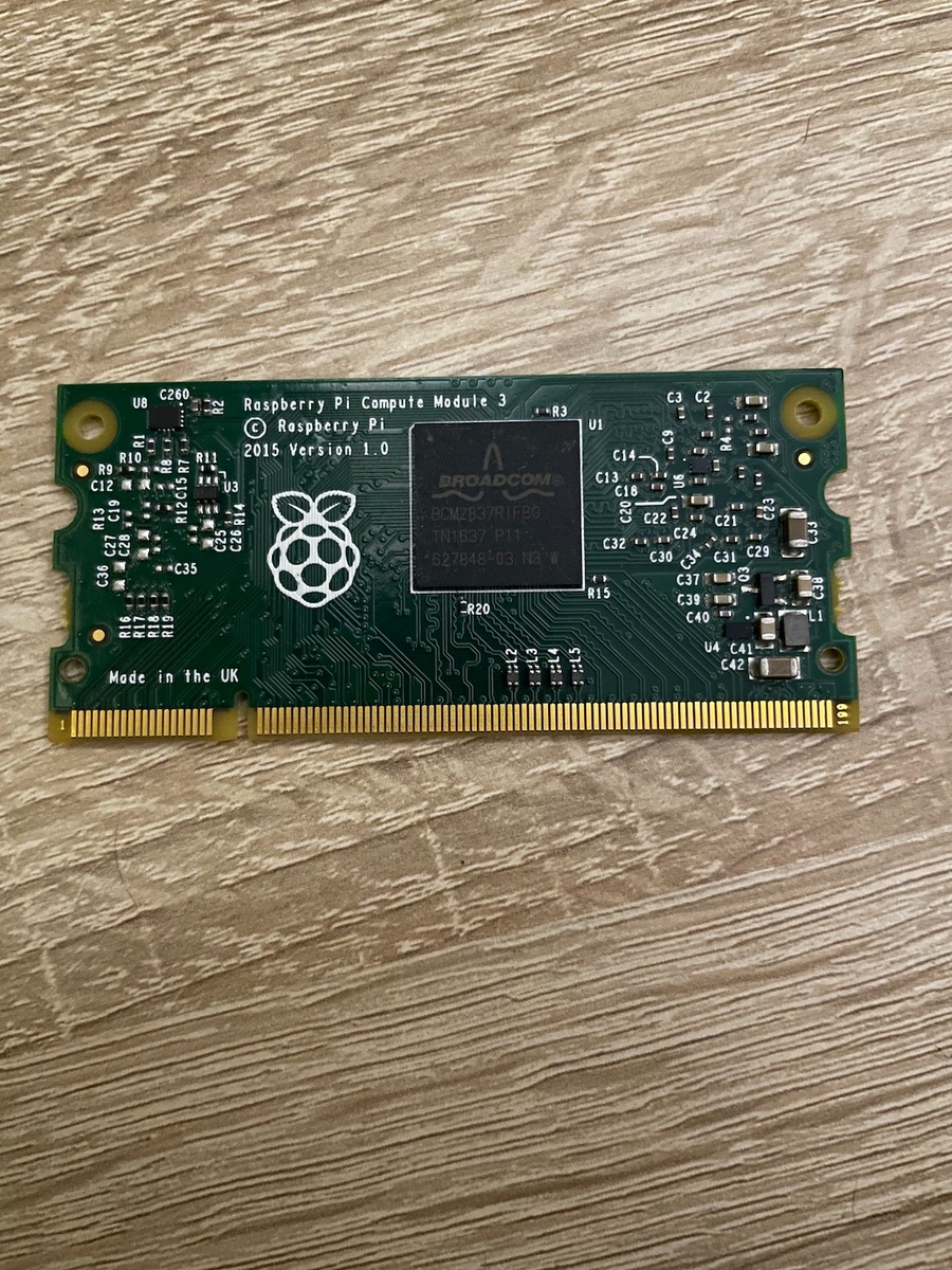

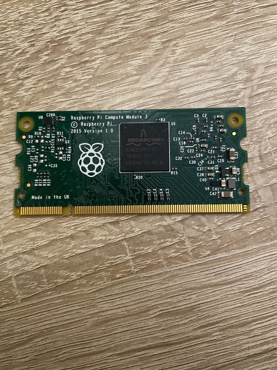

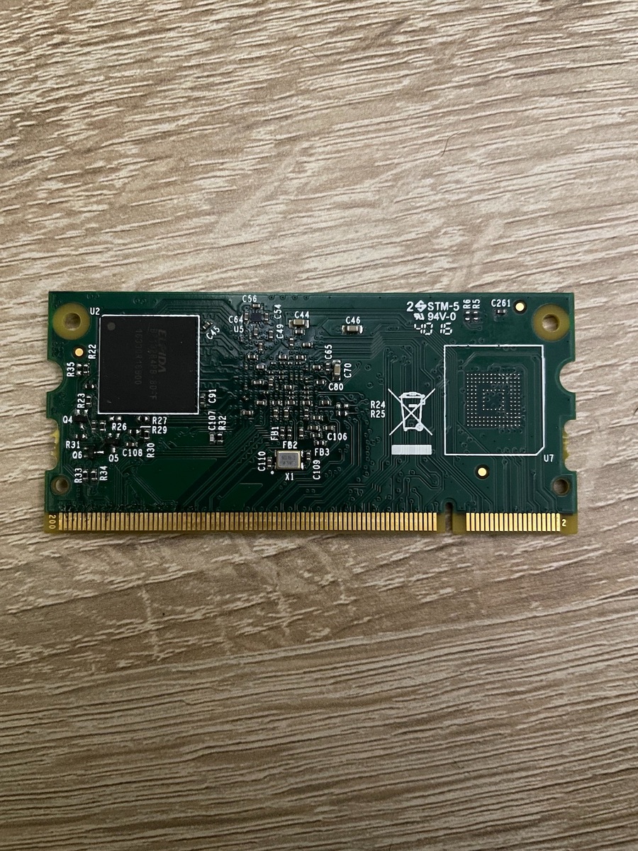

  • Ah... its me again. I bought a Compute Module 3 and wanted to install the image via the method above, so I downloaded the cm3 Slice image from here, but the slice with the cm3 don't appears in the windows disk menu so the raspberry pi imager can't write the image. I've made a quick video
    External Content www.youtube.com

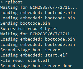

  • Just ran rpiboot to compare..
    theres some differences but looks like its not crashing out. does your CM3 definitley have flash memory, i think you can buy them without.
    other than that i would try a different usb port or PC and see if the problem follows the slice or the PC.
