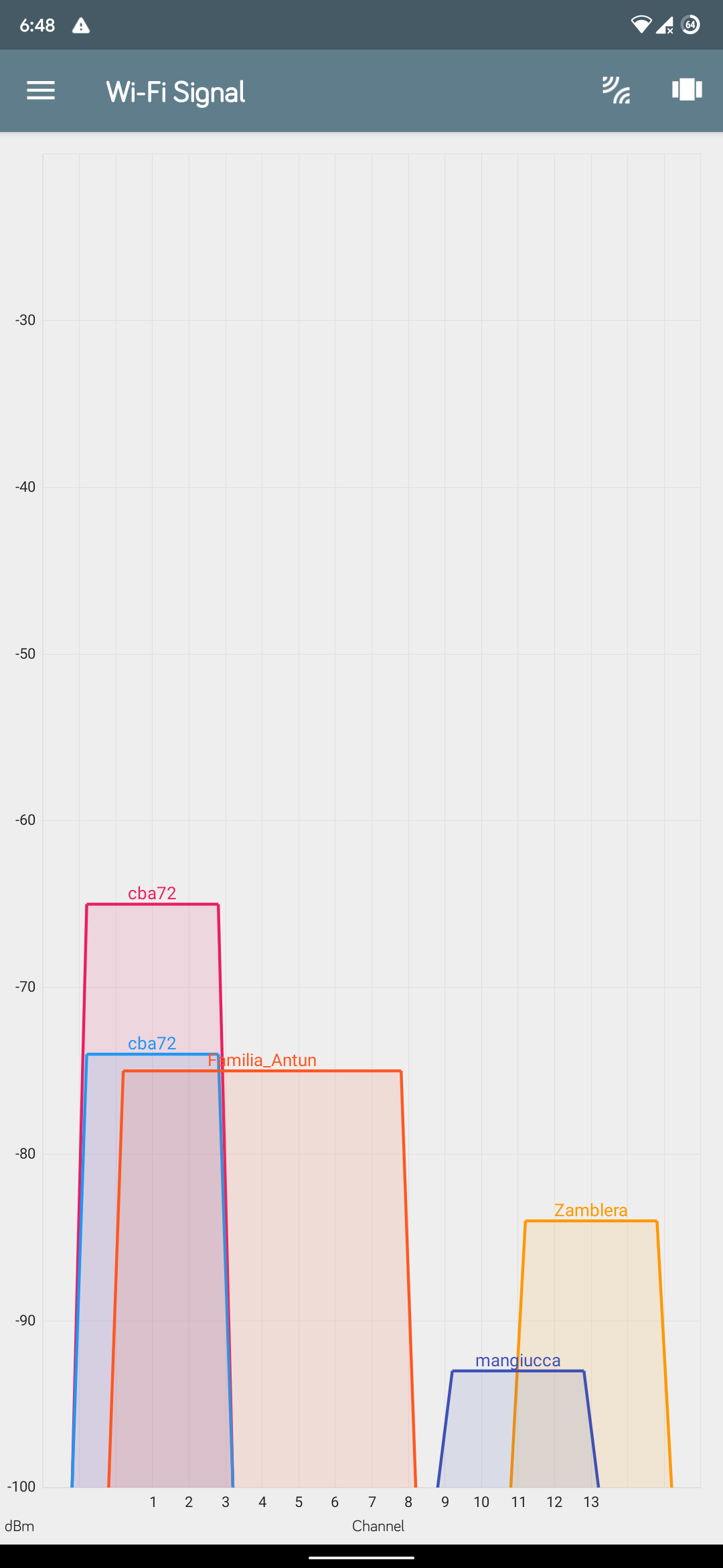

  • Thanks for the reply. Answering you questions:
    I cannot pick a specific channel on my router, the "ISP" (I think it's called) doesn't lets me access the router config webpage. It asks for a password that I don't have. Also, the distance between the PC and the router is small (no more than 5m), and the PC cannot see so many other neighbor's wifi. I've checked what you say about the wifi channels. None of the other wifi seem to interfere with mine.
    As you can see (my network is cba72) I don't have so many other wifis interfering mine. What it's strange, but I don't think it is a problem, is that other wifi network (Familia_Antun) that occupates almost 5 channels. Btw, you see 2 cba72 because I have a network repeater. It appears as one cba72, but I've tested shutting the repeater down, and sometimes the error also occurs.

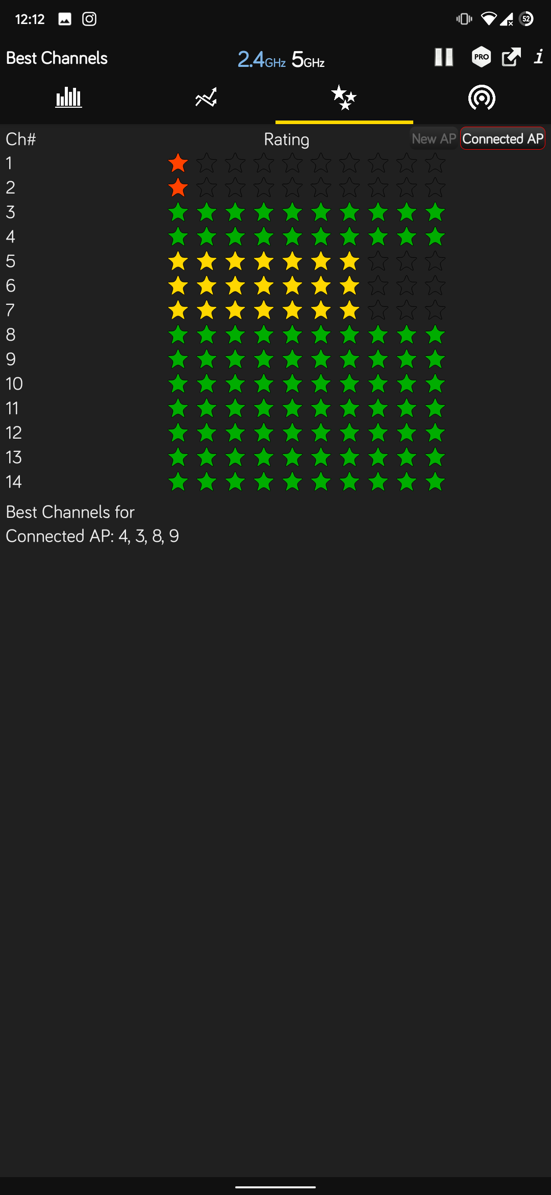

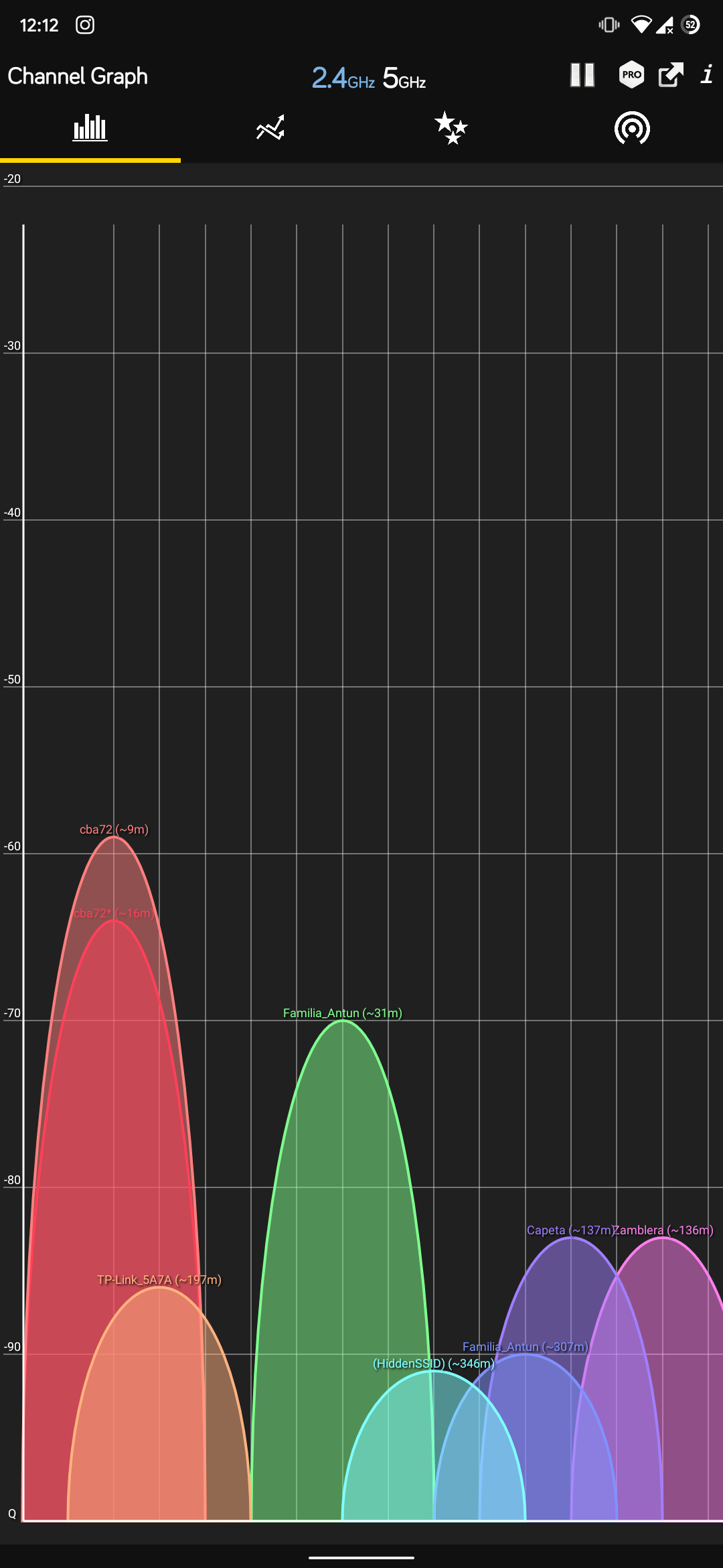

  • Ok. Thanks to your comment "usually the router password is in your manual" I finally accessed the routers webpage. In my country, ISPs, usually, lock the router, so the customers cannot change anything that they don't want. I was so lazy, that I only tried with the defaults (admin, admin) until now, that I read the manual and I found out that the password was a very easy password (admin, zhone). I will try changing the channel, now that I have access to the router, but I want to check some things before doing anything.
    If you look at the next image, you can see that almost all channels are occupied (idk why before I didn't saw so many neighbor's wifi).
    Now, this app has a tool that recommends you a channel for your wifi network.
    As you can see, the app suggest me to use channels 4, 3, 8, 9. Why? Aren't they already occupied?
    The other thing, is that I cannot move the router. Mainly because it's a fiber-optic router, and, as you might know, fiber optic is very fragile, and, also, the man that made all the electronics of my house messed up all wire channels, so, I cannot change the router location (also, I don't like the idea of having a wire on the corner of the sealing)
    My router is a DZS ZNID-GPON-2426A1.
  • A 2.4 GHz wifi channels are always occupied !
    - except you got a castle in the wood or on a hill (outside of all the "outlaws" out there) - ;-)
    what holds you off playing with the channels what the tool suggests ?
    but look at your screenshot:
    a) your wifi indicator (upper right corner of your smartphone display) says with your channel 1 nearly full wifi speed (until familia_antun moves again to channel 4 or so, I guess).
    b) channel 4 and 8 are both the flanks of "familia_antun's" parabola, so I would estimate more trouble there
    c) Famila_antun is the strongest wifi you see in your wifi equipment, so either go them completely out of their way(channels) or - according my writeup above - use extactly their channel.
    but it seems (your screenshot in comment #10) they use auto channel (yesterday 4, today 6): means you might never win until you do auto channel too - hoping the router software is smart enough -
    d) low parabola's means to me "far away" => less trouble.
    means Family "Zamblera" or "Capeta" could be your friend and I hope familia_antun wasn't smart enough to switch channel 13 on too.
