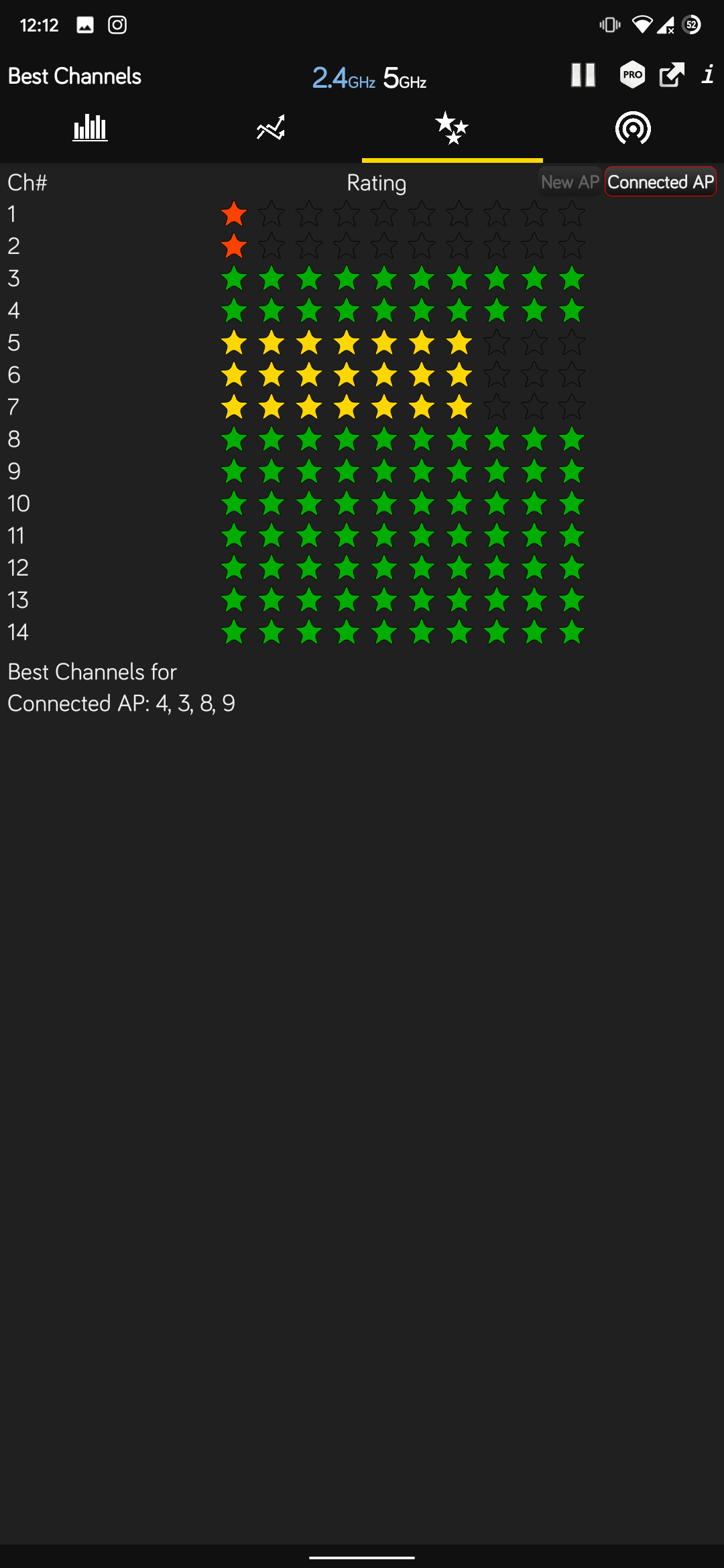

    If you look at the next image, you can see that almost all channels are occupied (idk why before I didn't saw so many neighbor's wifi).
    Now, this app has a tool that recommends you a channel for your wifi network.
    As you can see, the app suggest me to use channels 4, 3, 8, 9. Why? Aren't they already occupied?

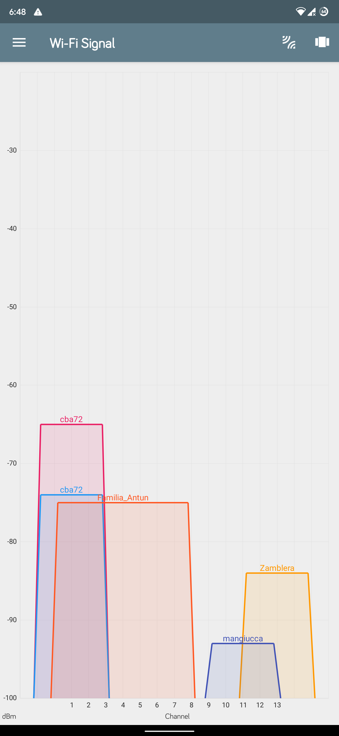

    I cannot pick a specific channel on my router, the "ISP" (I think it's called) doesn't lets me access the router config webpage. It asks for a password that I don't have. Also, the distance between the PC and the router is small (no more than 5m), and the PC cannot see so many other neighbor's wifi. I've checked what you say about the wifi channels. None of the other wifi seem to interfere with mine.
    As you can see (my network is cba72) I don't have so many other wifis interfering mine. What it's strange, but I don't think it is a problem, is that other wifi network (Familia_Antun) that occupates almost 5 channels. Btw, you see 2 cba72 because I have a network repeater. It appears as one cba72, but I've tested shutting the repeater down, and sometimes the error also occurs.
