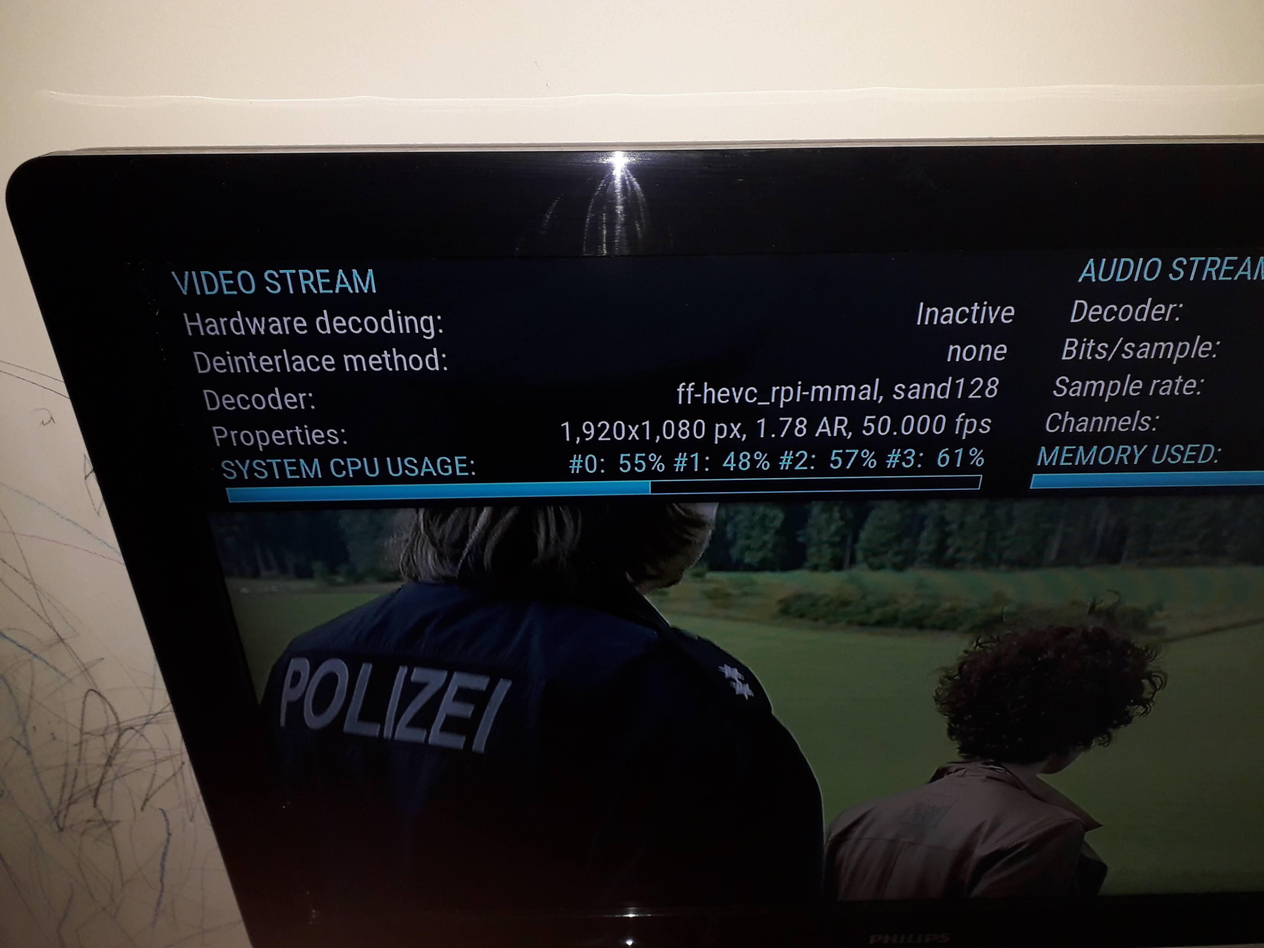

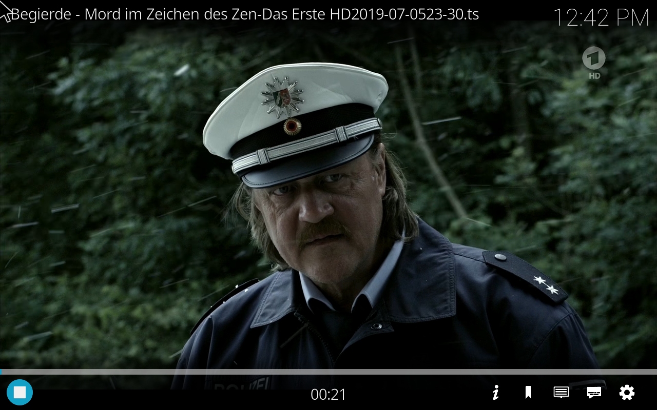

9.2.1 on RPi4: HEVC from TV recording has no playback controls
  • Now I'm at a loss... I have recordings that are 1.4 GB and show no playback controls, but if I create a part as described above of a larger video even a 1.8 GB file shows playback controls. Anyone with an idea what in the original files can confuse the player?

    On my Rpi 2 it's working fine with skin aeon nox silvo but I only see 2 controls with estuary skin..that s the one you r using..from your screenshot..Libreelec on Rpi...h265 videos where unplayable 2 years ago but now they done a huge inroad and plays flawlessly..
  • Controls are there, but they don't work... only stop-control has any effect. So I guess the aeon nox silvio is just not as adaptive as estuary...

    2020-08-27 12:37:24.760 T:2639012720    INFO: ffmpeg[9D4C2370]:   Duration: N/A, start: 67418.302400, bitrate: N/A
    It seems the decode cannot evaluate how long the playing time is --> Would explain why I cannot move in the file. Some lines above I find
    2020-08-27 12:37:24.422 T:2639012720   DEBUG: Open - avformat_find_stream_info starting
    and then a lot of errors. It seems to have trouble finding something named PPS and NAL.
    Later, when playing, it uses MMAL, so not ffmpeg, But ffmpeg tries - all the time:
    ffmpeg[ABD12370]: [hevc] av_rpi_zc_ref: *** Not one of our buffers: NULL
    It seems that ffmpeg does not have permissions to access MMAL stream/buffers? But if this would be the problem: Why would it work for other streams?
    I don't know, I have difficulties understanding the log - hopefully someone with more insights can make sense of it...
