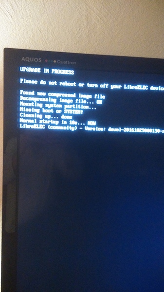

It looks like the update wasn't successful at all. Can you try once again, this time without putting a device tree in Update folder
I think the screenshot will help explain what happens during the update.
"Missing boot or System"
Me too same problem

fatjanhushi kostaman I have uploaded a .tar file with an update. Can you try using that one to update?

kszaq Just updated successfully with your .tar file. Placed the .tar on Update folder without a dtb file. Thank you! The problem now is that I have no audio. On System Settings>Audio - Audio output device shows Default, Bluetooth Audio (pulseaudio) and can not change.

Repeted update process with a dtb.img file and the audio problem is fixed. Thank you kszaq
