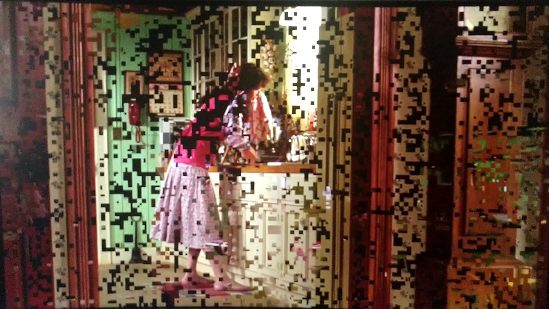

    I am using a Thinkerboard S and having issues with it. Everything worked fine up to version TinkerBoard.arm-9.1.501-rk3288 and all following versions even 9.2.1 are causing issues that I am not able to solve. I tried movies on my hard drive as well as videos on YouTube (Kodi YouTube plugin) and unfortunately, I am seeing in both cases just image interferences while I am watching Videos. Big pixelated blocks / clouds everywhere, not sure how to explain that properly. At least not watchable at all.
    I just did a fresh installation and tested it again with 9.2.1 and unfortunately I am having the same issues.

  • Hi,
    I checked your suggestion and used the lower resolution. Unfortunately it still looks the same heavy artefacts within the movie.

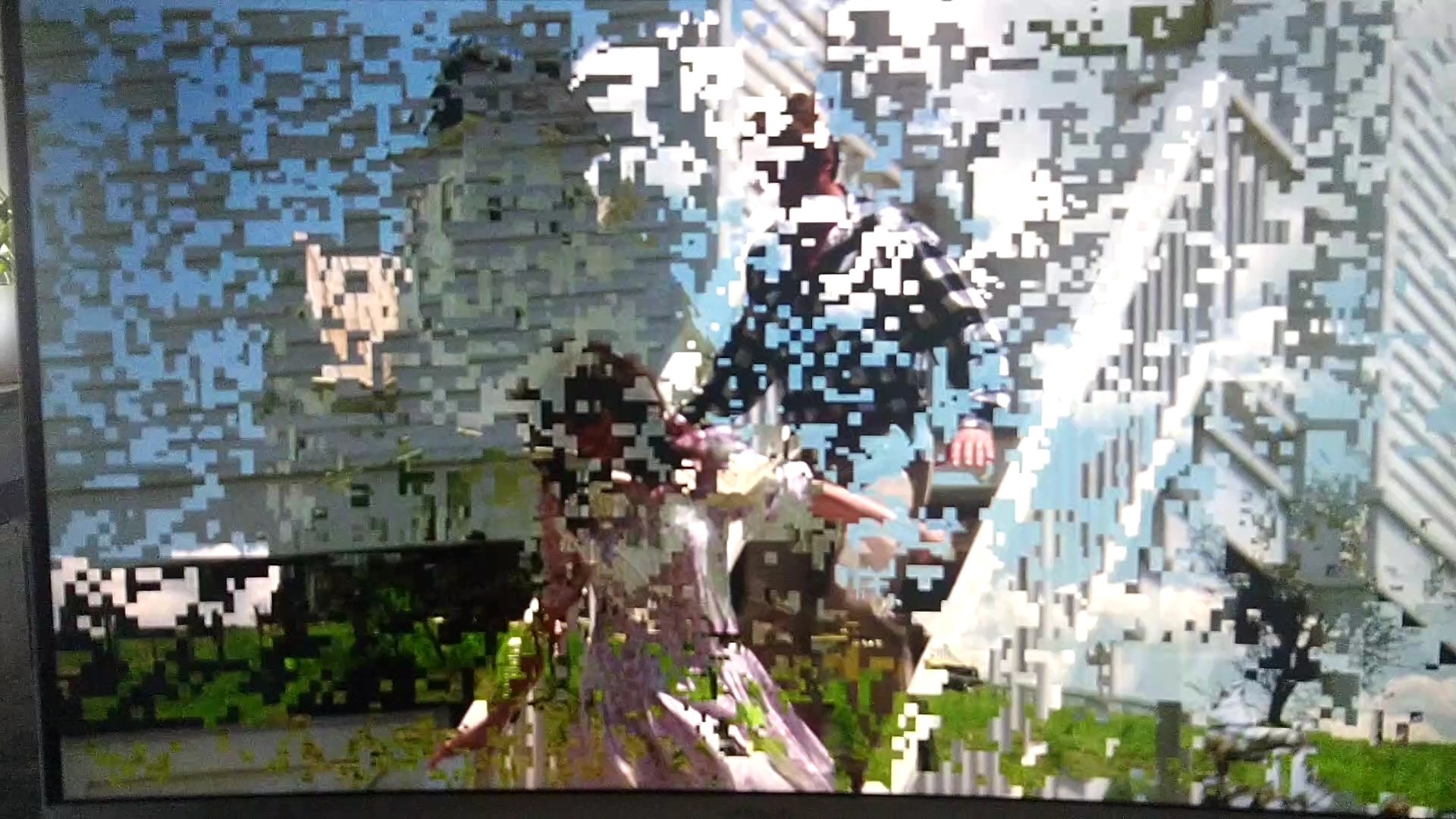

    The same movie on TinkerBoard.arm-9.1.501-rk3288 looks like that:
    External Content pastebin.com

  • Hi,
    I just tested
    LibreELEC-TinkerBoard.arm-9.2-devel-20200418151009-f8b66fc-rk3288
    LibreELEC-TinkerBoard.arm-9.2-nightly-20200418-f8c86fe-rk3288
    unfortunately they have as well these huge artefacts all over the place.
