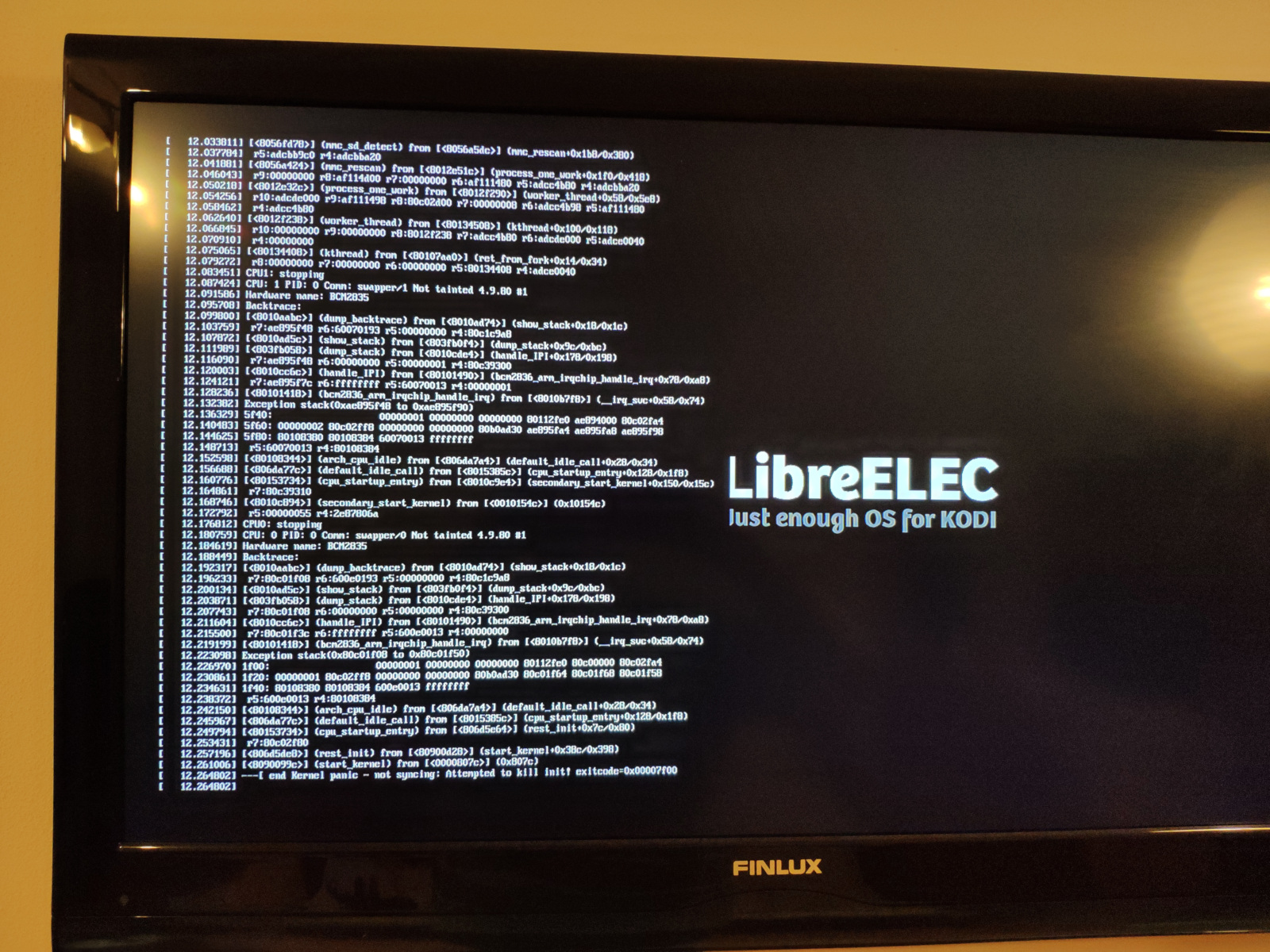

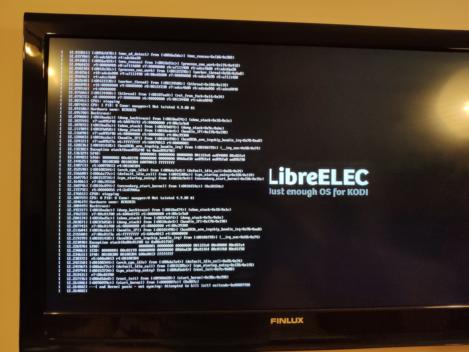

  • There was a problem booting #0322 (which is no longer available on the server) but the problem is fixed in #0322b, unless it's a different problem. Can you grab a screenshot/photo if it happens again?
    Sorry Milhouse, my problem was with #0322 build, and I didn't realize that you updated the file on the repository after that. I've just flashed the new #0322b build and it's working flawlessly.
    Thank you very much and sorry for the confussion. My mistake.
