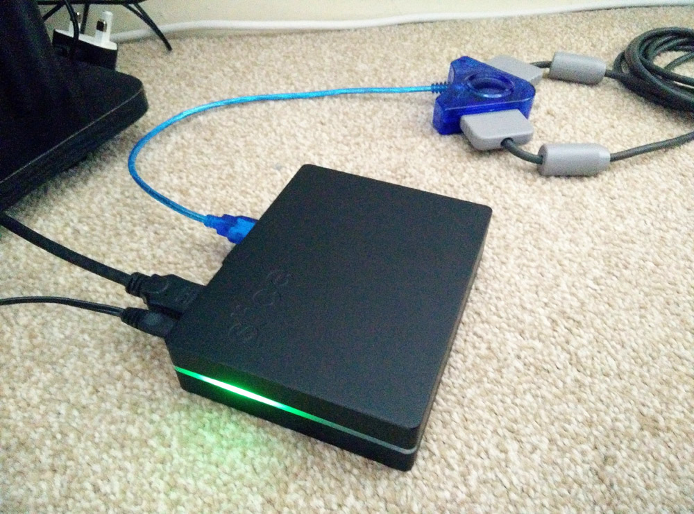

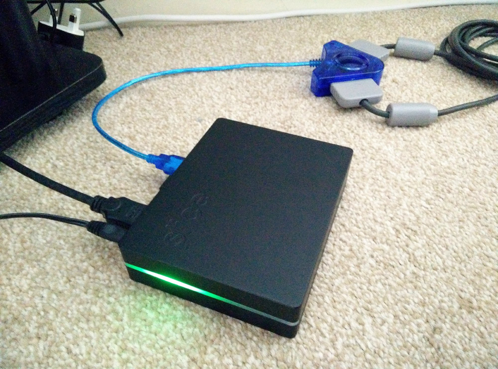

  • Thought I’d create a thread especially for the green LED bug, the more knowledge we can collect about it in one place the better the chance of a fix being created. The bug has been around since probably the beginning and occasionally people still ask about it.
    What is it?
    The LED strip will randomly light just one green LED, its always the same LED, the closest one to the power plug.
    Once the bug appears the only way to clear it is to unplug the power, rebooting does not clear the bug. the green LED will stay until a reboot.
