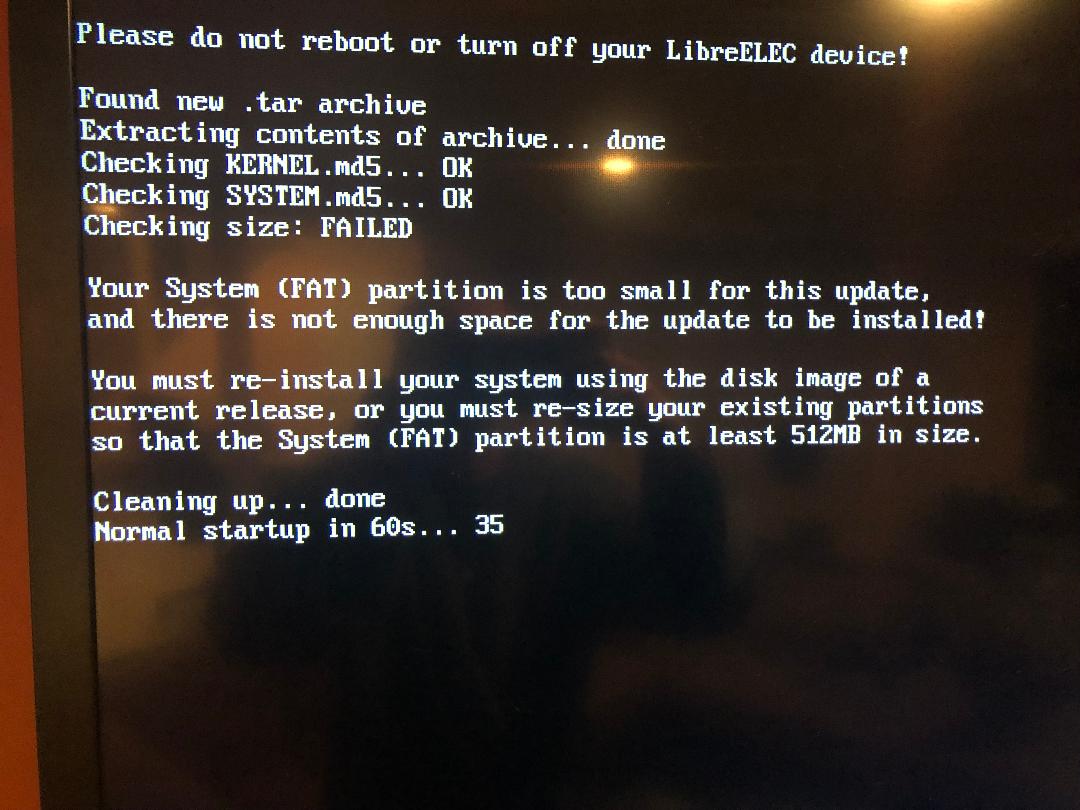

I've just ran into a problem trying to update one of my NUC's from 8.25 to 9.01 (Kodi 17.6 to 18.1), got this screen which is really confusing since it's got a 32 GB drive. Anyone have any ideas how exactly I go about fixing this please?

I'm guessing it's an older OE install that was cross-graded to LE at some point. OE used a 235MB boot partition and LE 7.x/8.x are around 230MB so fit within that partition size constraint. The LE 9.0 image has grown a little due to drivers and such and the 235MB boot partition is now too small to host the files so the upgrade aborts. To fix this you have two choices:
a) Backup the LE 8.2.5 install and move the backup file off-box, then clean install LE 8.2.5 (which gives you a 512MB boot partition) and then restore the backup; then update to LE9.0. This is normally the fastest option as most LE installs only have 1-4GB of actual Kodi data on the /storage partition that needs to be backed-up and moved and the reinstall/restore process is quick.
b) Boot an Ubuntu (or similar) LiveUSB and use gparted to shrink and then relocate the /storage partition to create space for the boot partition to be size expanded to 512MB or 1GB (whatever you fancy). This is normally the slower of the two options as you end up moving 31GB of data on disk.

When LE formats a storage device, the FAT partition is usually small, and the majority is taken by the Linux partition. Please check the size of the FAT partition. As user chewitt mentioned, you can use "GParted Live" a) to shrink the Linux partition and b) expand the FAT partition.
Of course you can start from scratch, too. A fresh installation will take the right FAT partition size.

Format the whole disk. After that, you should have a single Windows-readable partition. Then run the LE installer. The LE installer will reformat the disk, and you will get the two mentioned partitions - now with the right size of the FAT partition.

The backup file is in /storage/backup so use WinSCP to transfer over the network, or if a USB drive is locally connected (and mounted) you can copy the file using 'cp' from the SSH console or the Kodi FileManager in Kodi settings.
Or if you don't care about any of the existing data. Create an install USB using the USB/SD Creator app and boot/install. The install process will nuke everything on whatever device you install to.
