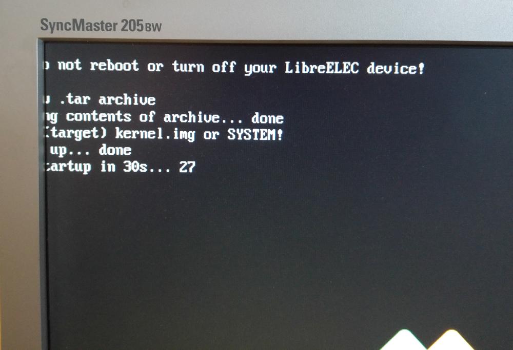

    Two day ago I tried to upgrade to the latest alpha (8.90.008) and realized that this also did not work. I then connected a LCD and saw that the upgrade script (packages/sysutils/busybox/scripts/init I assume) failed with "Missing (target) kernel.img or SYSTEM!". That made sense, because there was no kernel.img in /flash. There was just a /flash/KERNEL (and as far as I can remember has always been). I then created an empty /flash/kernel.img file and the upgrade finally succeed (but the upgrader copied the new kernel into /flash/kernel.img).

    First I just copied it into /storage/.update without changing anything else. Which again brought the "Missing (target) kernel.img or SYSTEM!" error as before:

    Any upgrade within LE9 versions is only possible if you do it manually. The message is always "system or kernel" not found - as far as i remember
    a.)
    LibreELEC-WeTek_Play.arm-8.90.009.img.gz into .update will lead to:
    b.)
    LibreELEC-WeTek_Play.arm-8.90.009.tar into .update will lead to:

    I updated a WeTek Play 1 to 8.95.001. After that, I was not able to downgrade again to 8.2.5, with the same "Missing (target) kernel.img or SYSTEM!" error reported as documented by benni0815.
