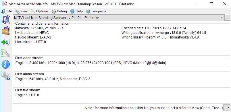

Seems like my Pi3 can't handle any kind of 1080p video using libreelec. I know this can't be the case. I must be doing something wrong. Can anyone give me any suggestions. Video files are on wired network.

HEVC (H.265) files require more horsepower to play. Stay away from these files with a RPi

blueribb is correct - there is no way the RPi3 can normally play HEVC at 1080p. Maybe the RPI3B+ might be able to but I haven't tried. I tried a milhouse build on a normal RPi3 which had a few tweaks and seemed to work at 720p.
Easiest way is to use "Handbrake" to convert to X264 - although not on a Pi unless you have a few weeks to spare
Milhouse builds (Kodi Leia) do a pretty good job with HEVC 1080p videos on a RPi2/3/b+. Obviously not the very high bitrate videos, but the usual rips video have a good track record.
So anyone have any suggestions with, say, ffmpeg to transcode these videos to something the PI could handle?

use milhouse builds the latest Kodi18 builds have several improvements at the HEVC department
A quick search shows many examples. This should work on a Pi.
