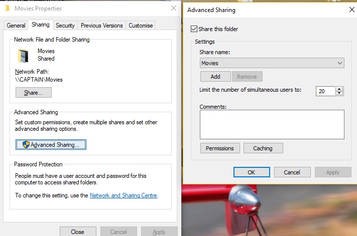

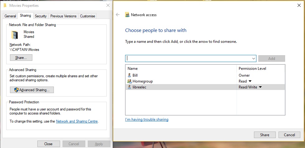

Please show the share settings in windows. If it's your windows user then use this user plus the login password for windows
There's screen captures of those a page or two back I think. And in the last video link I posted.
Thanks for trying fellas ....
Please go to the properties of the folder on windows 10, and then take Screenshots from tabs security and shared properties (or all tabs)

Okay I think I have all the screen captures you wanted.

Windows allows you to set the password of a user when you create the new Windows user - that's where you set the password, in the Windows "User Accounts" Control Panel. If you haven't created a user *with a password* then you won't be able to authenticate using SMB when connecting to a Windows share as Microsoft recently made authentication mandatory. Once you've created the Windows user with a password, add this user to your Windows share with the relevant Windows file permissions.
When you access the share from LibreELEC (with default settings) you should then use the new Windows username/password for authentication.
Also, you have posted the contents of your passwords.xml where you appear to be using a username/password of kodi:kodi (all lowercase), but then in one of your Windows screenshots you've added a user called Kodi (uppercase K), and in yet another screenshot you're using a user called libreelec. This conflicting information doesn't make solving this issue any easier, but points more strongly towards an incorrect configuration.
If you've tried accessing the Windows 10 share from Windows 7 and you are not being prompted for a username/password in Windows 7, then you have not configured the Windows 10 share correctly.
