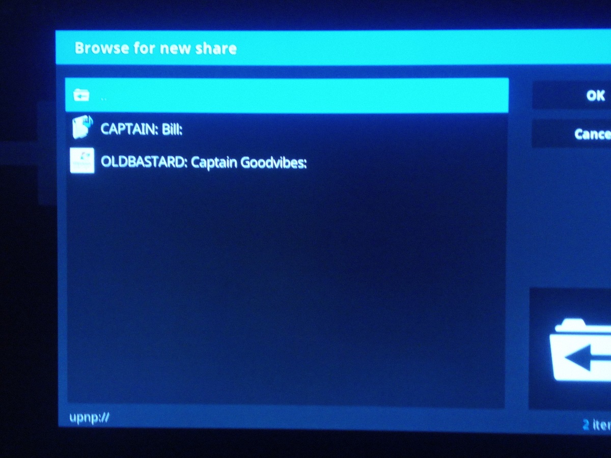

    It probably has, but the LE box can't find this computer on the network so we haven't got that far yet.

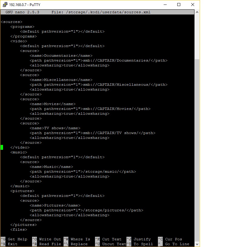

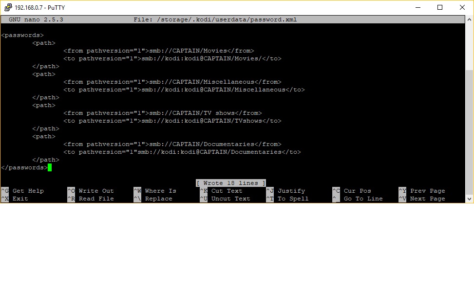

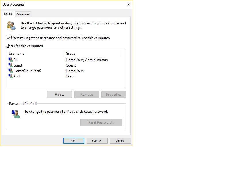

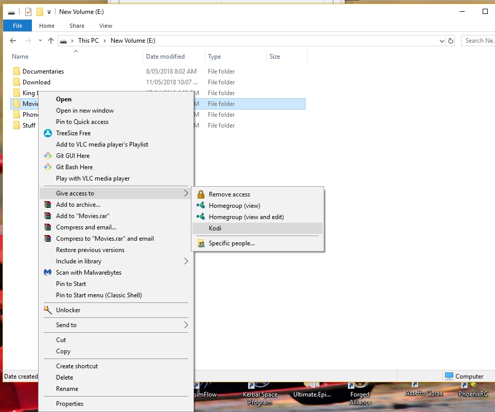

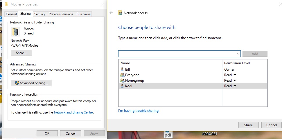

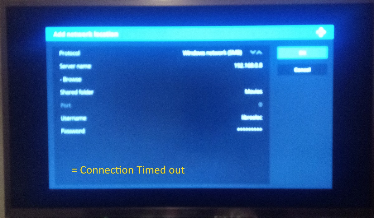

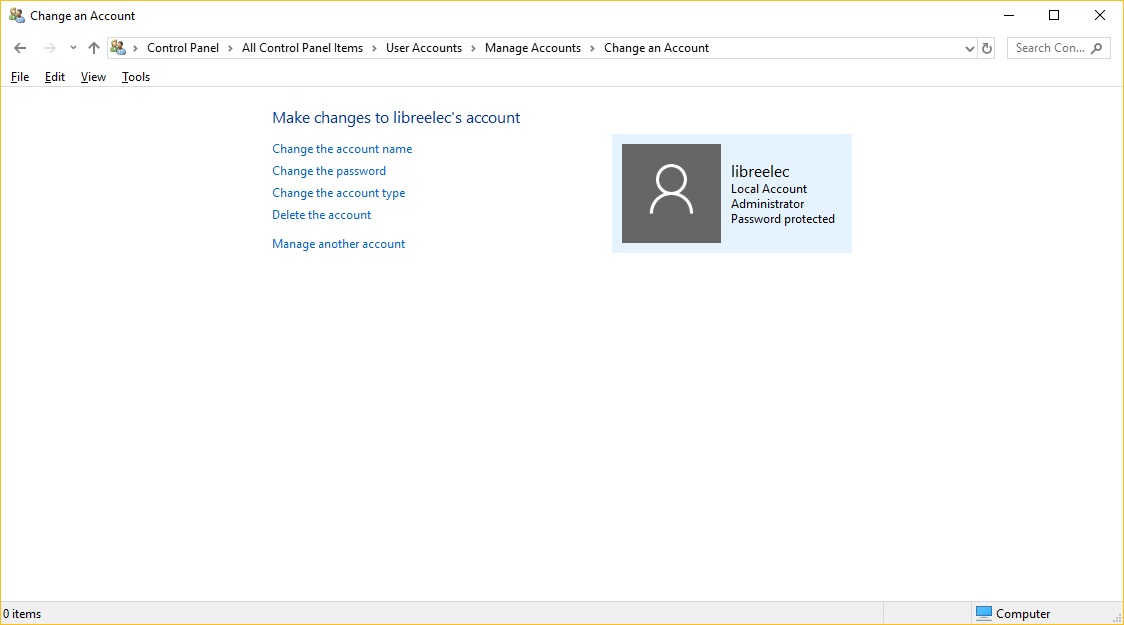

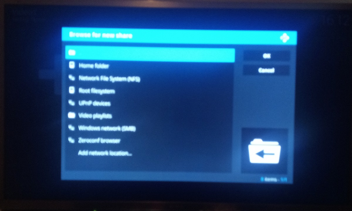

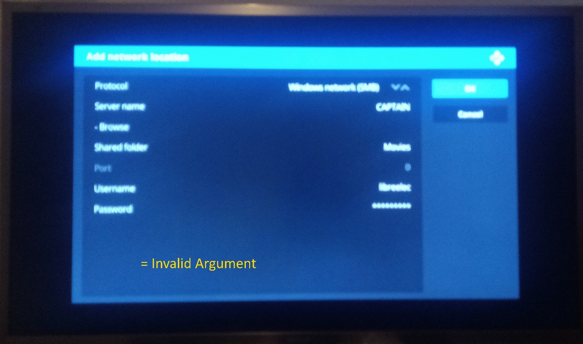

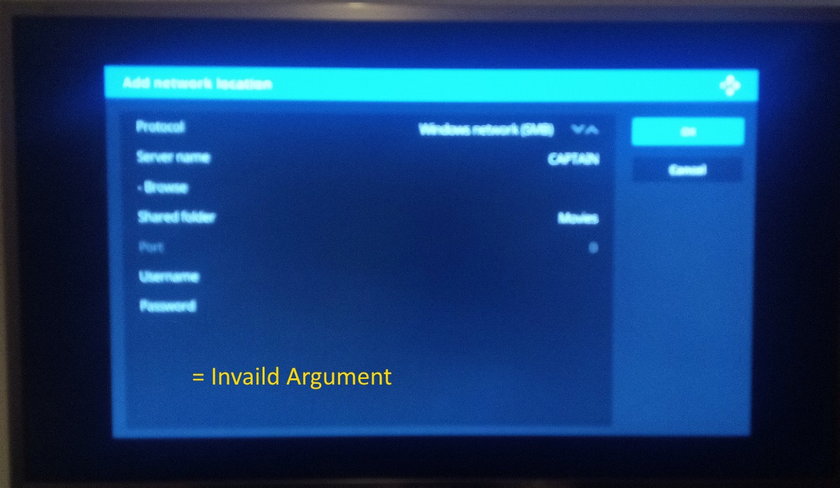

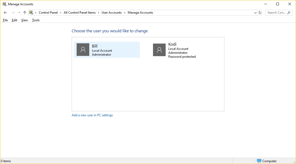

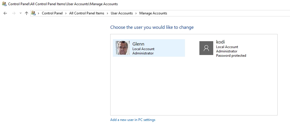

  • Okay I've found the thread that blueribb started and it's quite helpful. On it is a post from CypherZ ->

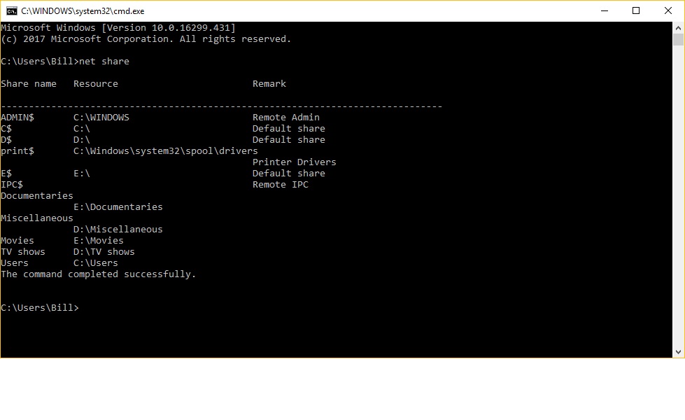

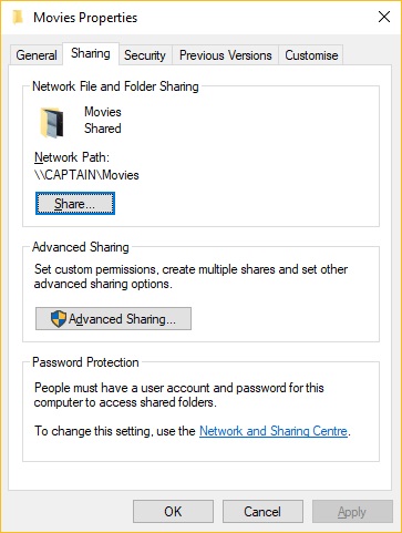

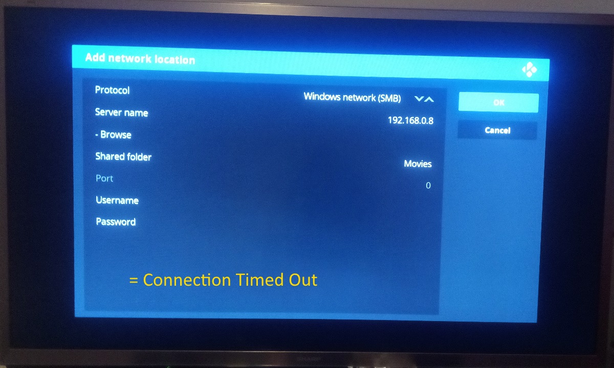

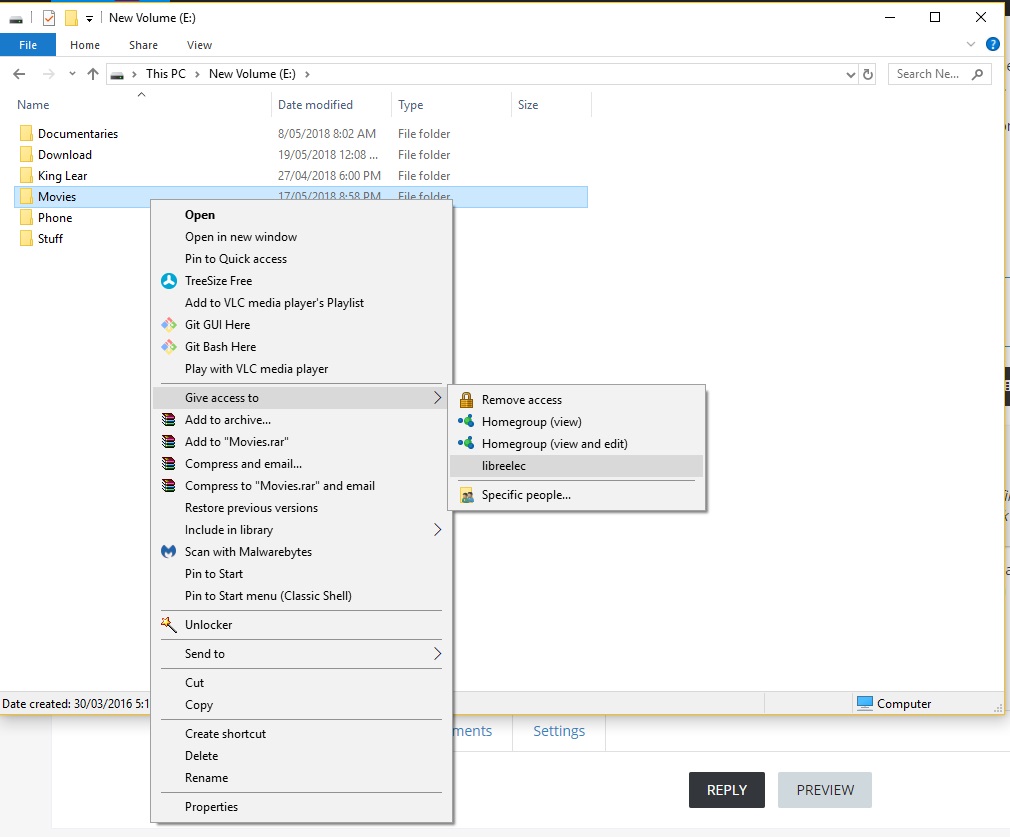

    I've done all of that. When I try to connect with the LE box, an 'invalid argument' error window pops up. Maybe I'm not getting the syntax or something not quite correct, I'm not sure. Anyway, some screen-captures from this W10 box, to make sure what I've done so far is correct.

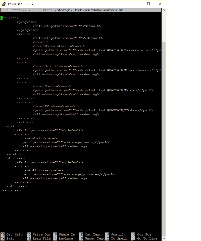

  • The "Kodi" user needs to have a password. Then you need to edit the existing 'sources' in Kodi to use that username/password (credential) when accessing the shares on the Win10 box. That can be done in the GUI (edit source). It can also be done manually by accessing the LE box over SSH and editing /storage/.kodi/userdata/sources.xml in a text editor (nano). As scary as that might sound it's often the quicker and easier way to edit things. The URL's in sources.xml need to be in smb://user:[email protected]/path format.
