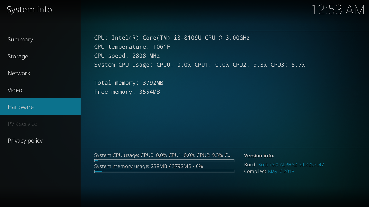

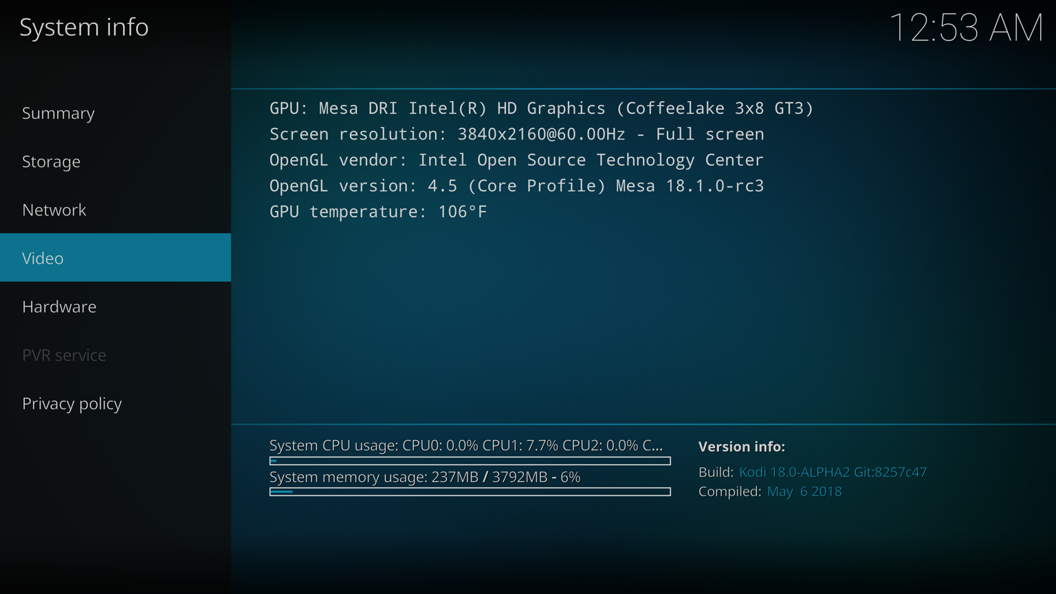

nice sky42
I don't have to much time to make builds for community, mostly I build for raports issue, bugs etc.
and behind the scene make pressure on Intel to fix this asap,
Coffe lake is ready to go - I didn't expirenced any issue on my build, I'm only didn't test HD audio
btw. also I'm advice use drm-tip kernel version for Gemini and Coffe - the driver version is far away from 4.16
and maybe is good add to your build drm-debug in syslinux, then users easly with no extra work (editing) will could post logs on BZ
