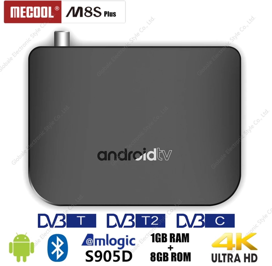

HI.
Android rom DVB T2 support . Wait update C......
Libreelec,Coreelec (not micro sd slot(USB,reset buton) OK)
Coreelec says:
FeaturesKodi v18 Leia (Beta)based on LibreELEC/master (05/08/18)nougat kernel by @kszaqavl6862
dvb driver for KVIM2 and MeCool devices by afl1
open-source wetekdvb driver by afl1
OpenVFD by @arthur-liberman *Entware package manager
Can you test if tunner works well?!
Sorry Iridium and Aroosha, but that box have builtin DVB-C tuner. I dont find what is the tuner chipset, so i open this topic to find if somebody have one, to test with libreelec before buy...
Thanks a lot my friends, for your help.
Cheers
i'm planning to buy MECOOL M8S Plus, but i need to know if tuner DVB-C will work on Libreelec.
Somebody can confirm me if it works?!
Cheers
