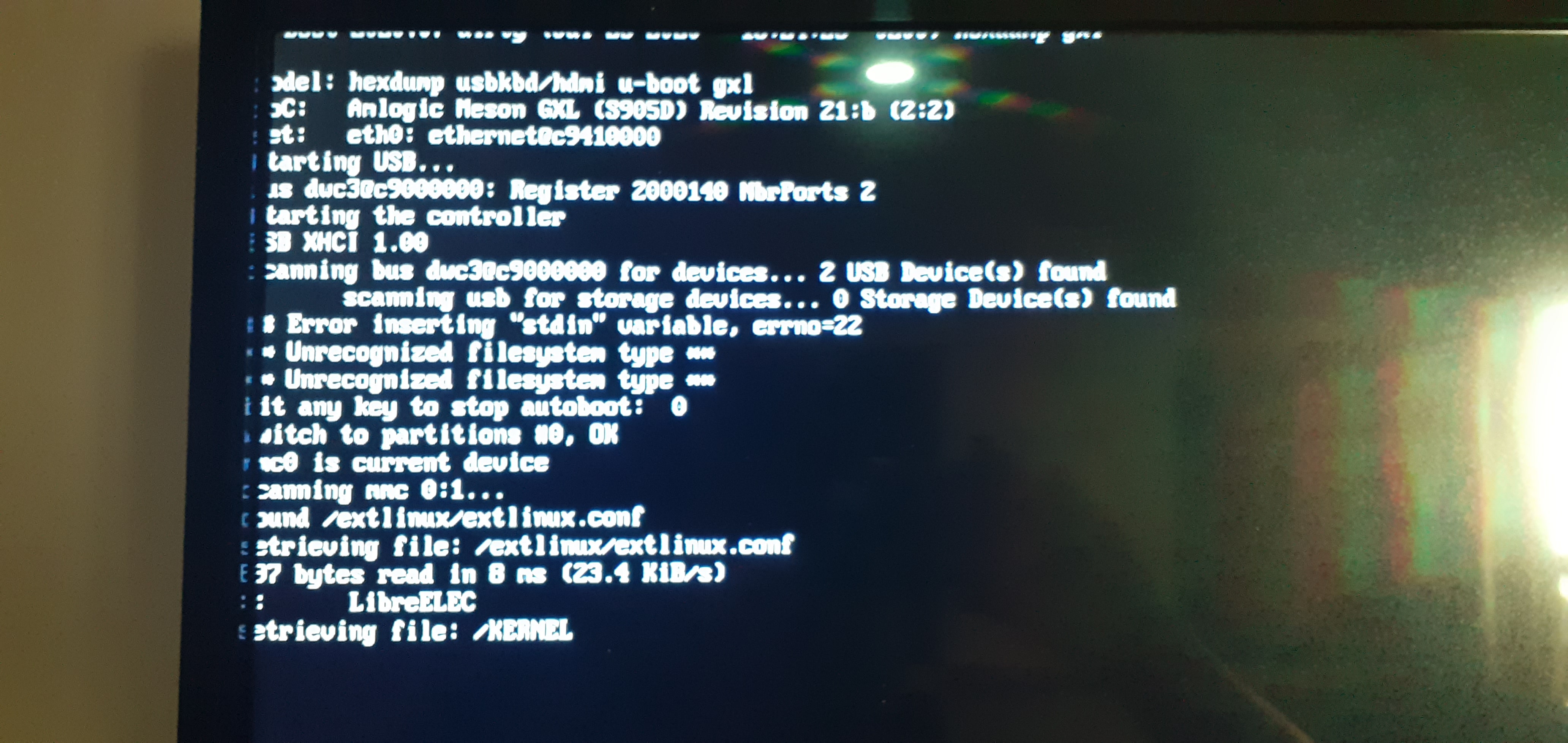

  • Thanks balbes150 - I'm afraid I don't have the necessary cable to connect to UART. If it's of any help, this image from @chewitt's test repository did boot, but I had a number of minor usability issues - LibreELEC-AMLGX.arm-9.80.7-odroid-n2.img.gz
    Let me know the exact image you tried to boot, and what exact steps you took. I will generate a boot log for you.
  • Thanks cdu13a - this is the image I downloaded and burned to an 8GB uSD card - LibreELEC-ARMv8.arm-9.80-devel-20201123124859-d174eba-odroid-n2.img.gz
    I edited extlinux.conf to point to the n2-plus dtb. Contents as follows:
    LABEL LibreELEC
      LINUX /KERNEL
      FDT /dtb/amlogic/meson-g12b-odroid-n2-plus.dtb
      APPEND boot=LABEL=LIBREELEC disk=LABEL=STORAGE quiet console=ttyAML0,115200n8 console=tty0 systemd.debug_shell=ttyAML0
    Powered off the N2+, removed the existing eMMC card, inserted the uSD card and ensured the switch was set to MMC position. My N2+ is connected to the TV through a Sony AVR.
    Powered the N2+. Nothing on-screen.
    LABEL LibreELEC
      LINUX /KERNEL
    If I use a CE image (9.2.5) burned to a uSD card, the screen will immediately display text indicating the image is checking the system and re-sizing the storage partition and then re-boot into CE.
    balbes150  fat-tony Attached is the uart boot log with same image following the same steps as above.
    balbes-boot-n2plus.log.txt

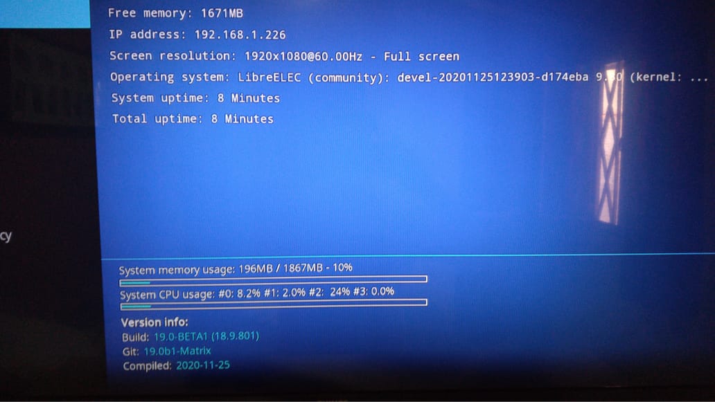

  • balbes150 The newer buildings are working, everything went well.
    Thanks. :thumbup::thumbup::):)
    The chewitt constructions are also working, only the kodi is out of date, still alpha and not beta. :thumbup:

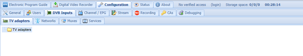

    CvH Is there a way to activate a usb tuner? tbs5520se or even tuner mecool AVailink avl6862.:?:

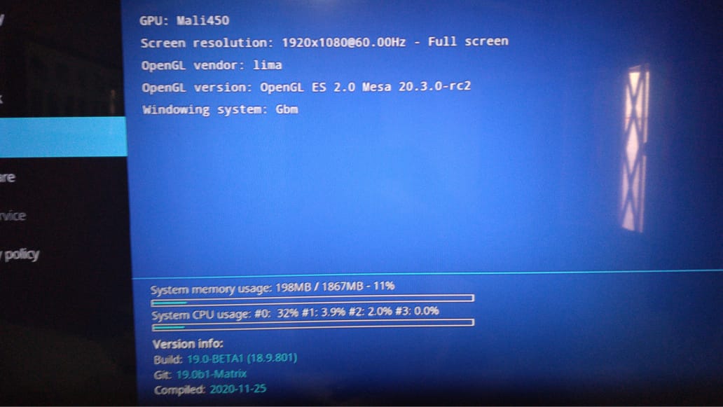

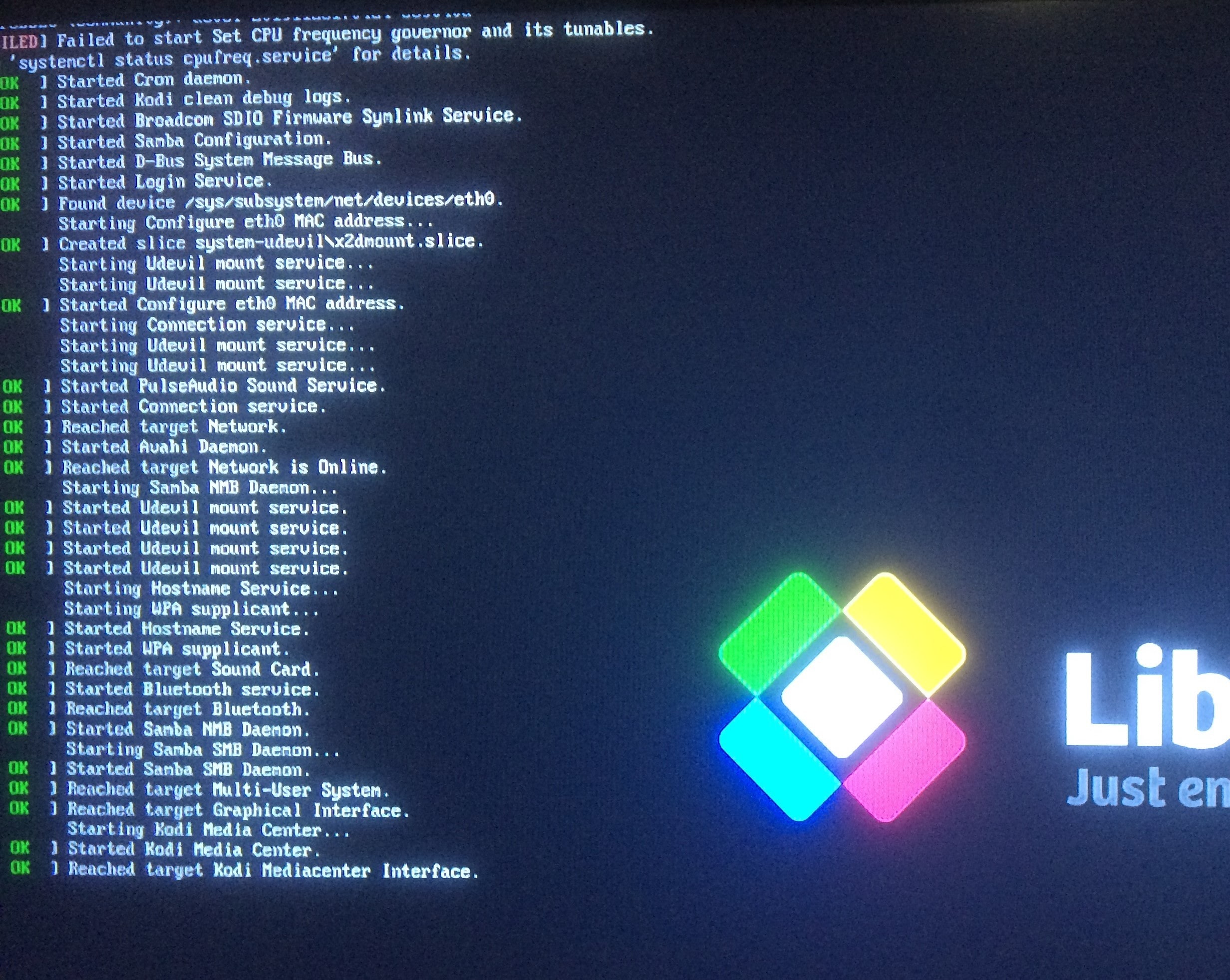

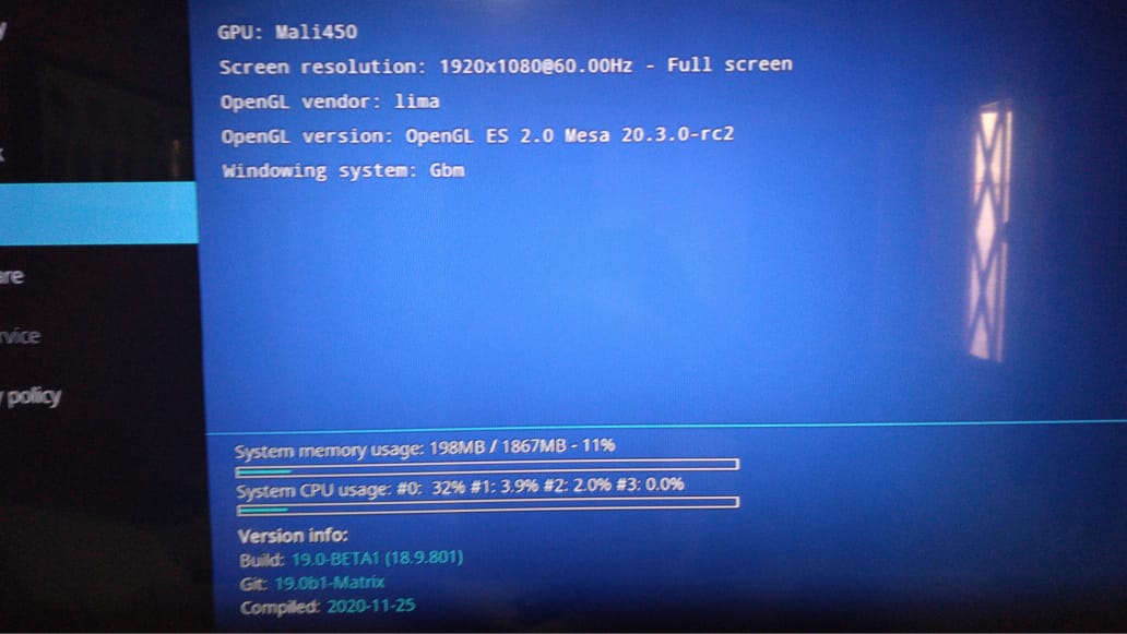

  • I tried the image LibreELEC-ARMv8.arm-9.80-devel-20201123124320-d174eba-amlgx.img, it started well, but it does not recognize Wi-Fi networks, or cable. What I can do?
    CPU S905D
    RAM 2GB
    DVB
    AP6212
    Thank you so much for everything
  • CvH Is there a way to activate a usb tuner? tbs5520se or even tuner mecool AVailink avl6862.:?:
    Unfortunately, doesn't look like it will happen for Mecool dvb tuners. It's a shame the Chinese company wouldn't sponsor projects like libreelec/coreelec for this work - though I understand they only care about android not Linux.
    In Coreelec, afl1, the guy familiar with dvb tuners has left the project so there is no-one knowledgeable about them to work on them.

  • I haven't had any contact with afl1 for 18+ months and I have never knowingly been in contact with any MeCool developers.
    I do have direct contact with Availink who create the demod chips, but their repo is quiet since the summer (no idea why) and I haven't spoken to them for a while either. I got their new demod driver to compile, but quite a bit of work is needed to disentangle all the other drivers (tuners, demux) from their code so that each driver follows kernel APIs and can be independently compiled. Someone also needs to write a V4L2 deinterlace driver because we cannot use the Amlogic vendor drivers; it's written against a bunch of proprietary APIs that don't exist in the mainline kernel.
    TL/DR; I wouldn't expect to have "integrated" DVB stuff working anytime soon.
