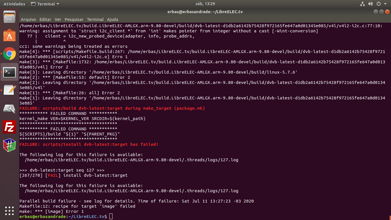

  • balbes150 my apologies for posting here, everything is part because it is about development! Their DVB modules are also disabled.
    I build it: PROJECT = Amlogic DEVICE = AMLGX ARCH =
    My problem is when I try to build with active DVB modules. CvH
    LibreELEC.tv/options at master · LibreELEC/LibreELEC.tv · GitHub
    chewitt I get errors, Is it possible to align the modules with the kernel? or we still have a lot of work!
