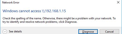

  • I already tried connect to my RPi directly over IP, but it does not work, when I have minimal version other than SMB1!
    C:\Users\Erik>ping LOZNICE
    Pinging LOZNICE [192.168.1.15] with 32 bytes of data:
    Reply from 192.168.1.15: bytes=32 time=2ms TTL=64
    Reply from 192.168.1.15: bytes=32 time=74ms TTL=64
    Now I enabled Network Discovery on my computer. And \\LOZNICE works, but \\192.168.1.15 still doesn't with minimal version sets to SMB2.
    Port test says that 445 is open.
    Stranger Things....
    • Official Post
    If using SMB2/3 the Win10 (client) requires an authenticated connection; i.e. you MUST enable user/password on the LE (Samba) server else the auth attempt fails. I'm starting to think we need to enable authentication as the default because Win10 users appear to be generally incapable of turning things on for themselves.
