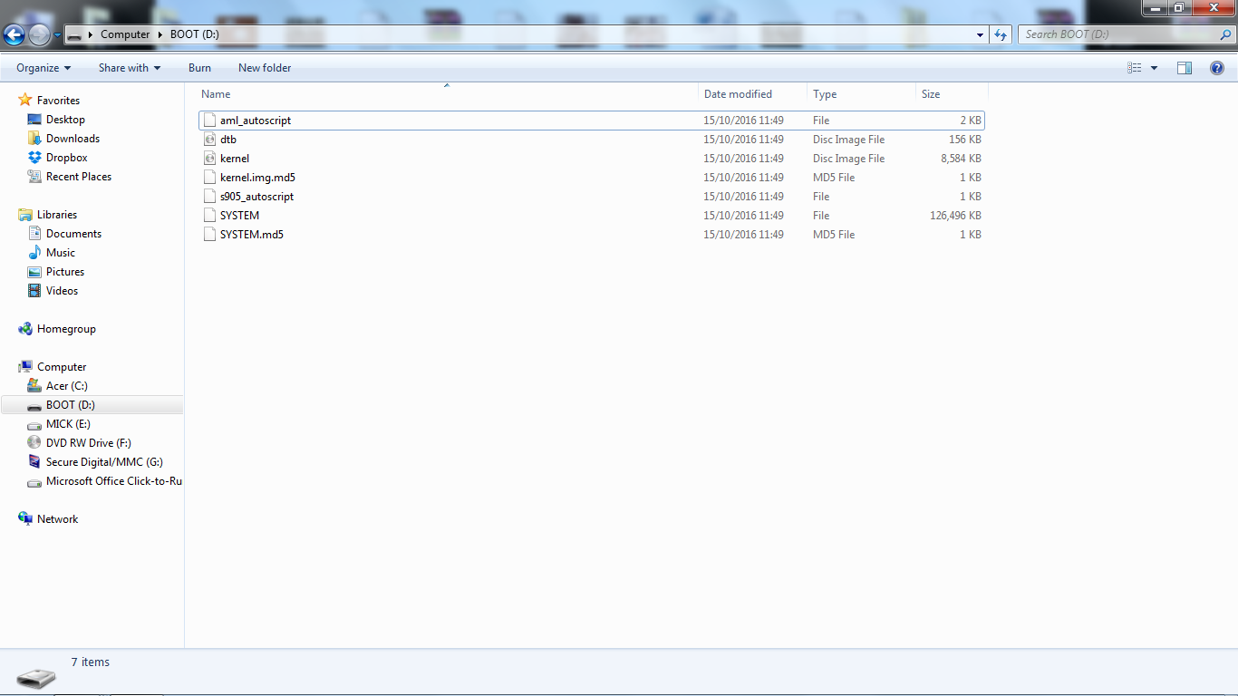

  • hi mate
    loaded files on to sd via rufus , stuck in box holdin reset in
    but I just got boot normal robot screen 9 from sd etc checked contents not showing files (attached)
    which are in pic... :(
    Seems like you need to get the correct device tree. If you installed version 7, then try another device tree from here device_trees
    If, version 8, device_trees
    I don't know what device tree is correct for your device. Try them one at a time. download the device tree, rename it to dtb.img then copy, (overwrite) to the boot folder on the sd card. If that doesn't work, then try another & another, if that doesn't work, then I have no idea.
    I see from your picture, you are not showing the file extension, you need to show it on your pc. I do not know how to do that on your pc, you will need to google.
