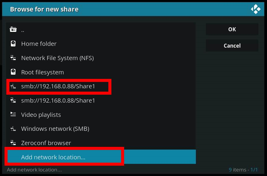

Hi guys. Sorry if this is just another junk thread, but I have been googling in order to find an answer. I found some information, but I do not really know what to do
Today, I wanted to start fresh with a new installation, so I took the latest release (8.2.5) from the site using the usb creator SW. Installation went through smoothly, as always. But when I started to add media, I couldn't find my SMB shares. Well, off to Google, where I found something about that SMB v1 is obsolete.
Since I didn't even know that there are more versions, I have no clue what my "server" uses, it runs windows 7.
Anyway, what should I do? Enabling SMB v1 in LE sounds like a temporarily solution (though this didn't work for me). Do I need to disable SMB v1 on my windows machine, serving as media server?
Thanks in advance!
