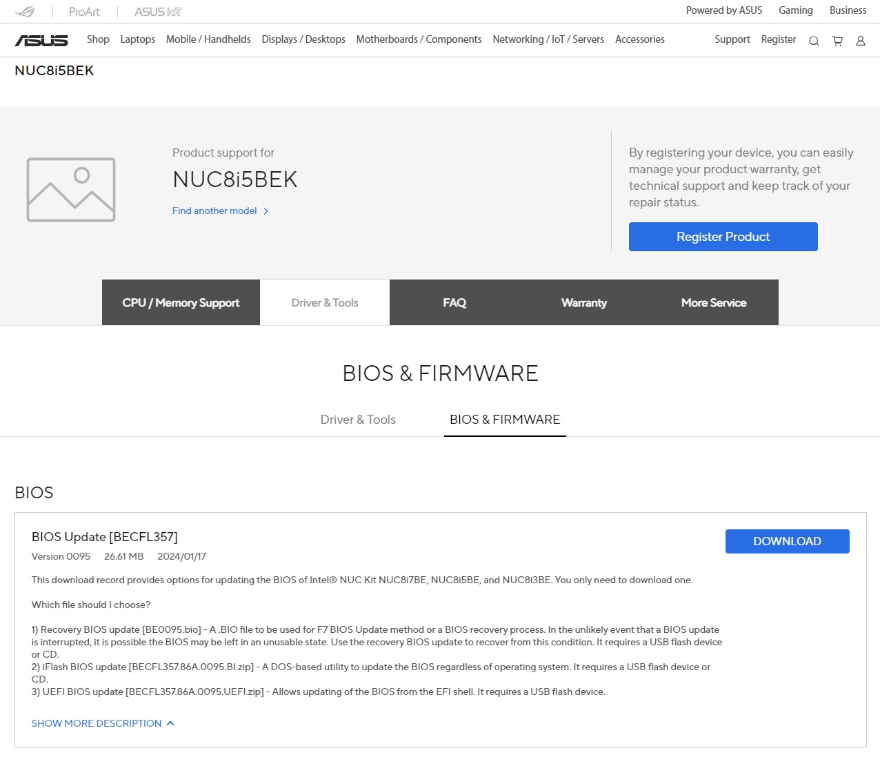

I have the zip I downloaded but no link on MS or Asus now Asus has take over NUC support.
I'm making a portable version of Windows 10 on a USB Drive right now, but I can't find NUC8ixBE-HDMI-FW-Update-Version 1.78.4.0.4
I was able to find 1.78.4.0.3 and it's dated Dec 2020. Any idea where I can download the latest version? Asus hosts the BIOS Updates but not the HDMI Firmware update.
