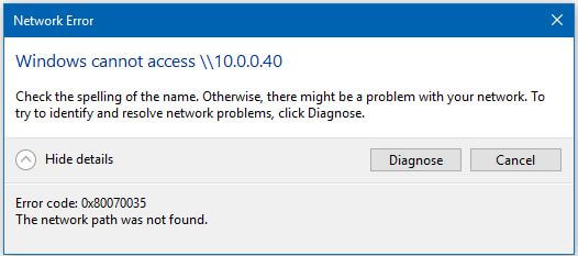

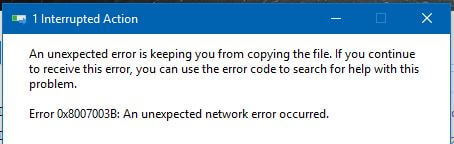

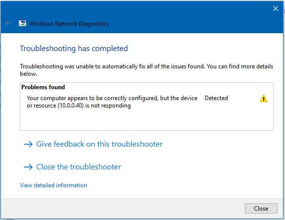

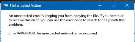

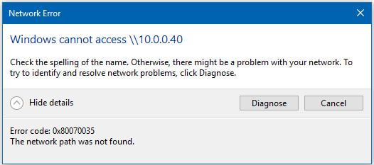

Potentially, yes. Is the LE or Windows PC connected over wifi? A flakey router or access point could result in lost packets that might confuse Windows. If wifi is involved try testing only with wired connections and see if that is more reliable.

both are on wifi.
the router it on the landlords floor above me.
so i cant reach it
