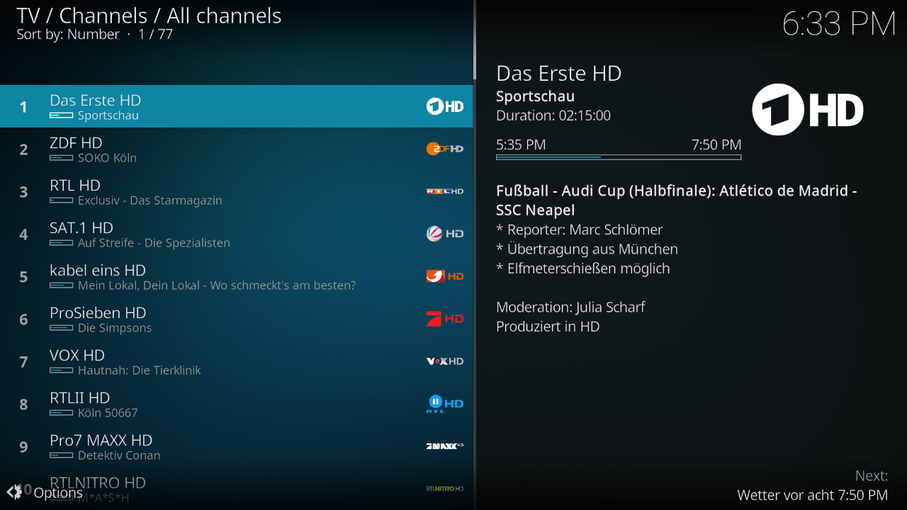

    You use Kodi as "player" that can easily work with "any" tv server you chose.
    Regardless which tv server you choose (vdr, Tvheadend, MediaPortal ...) you have always the same design etc. at Kodi because Kodi has plugins named pvr.hts (Tvheadend) pvr.mythv, pvr.vdr ... that connect to your existing tv server. These plugins gathering all needed information from your tv server and "connect" them into Kodi.

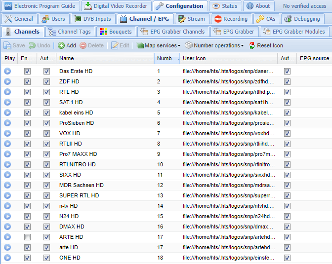

    So you install LE, install Tvheadend 4.2 addon -> go to http://ip-of-your-htpc:9981/ to get a webui where you can scan/sort/edit ... your channels. After that you just install pvr.hts and your channels are available at Kodi.
    Tvheadend WebUi
    default skin for kodi
