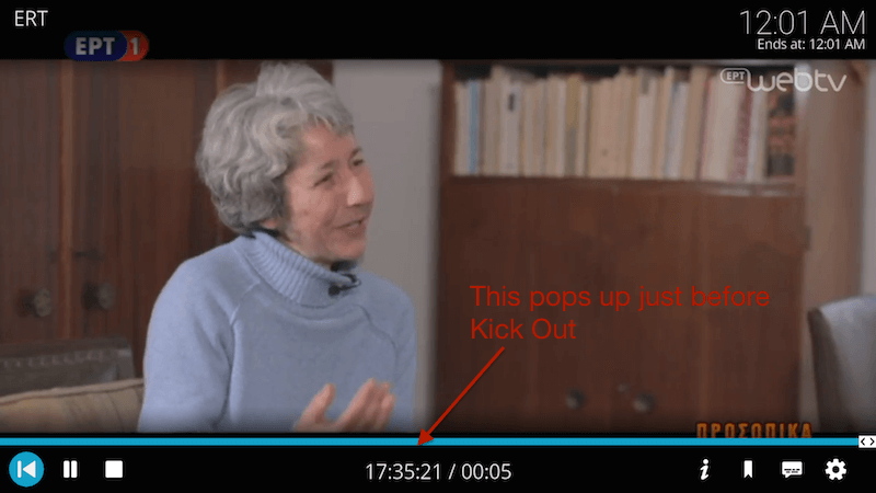

    I just clean Installed 8.0.2a and took Debug Log attached.
    Screenshot taken Just before Kickout.
    log-2017-06-05-00.07.10.zip
