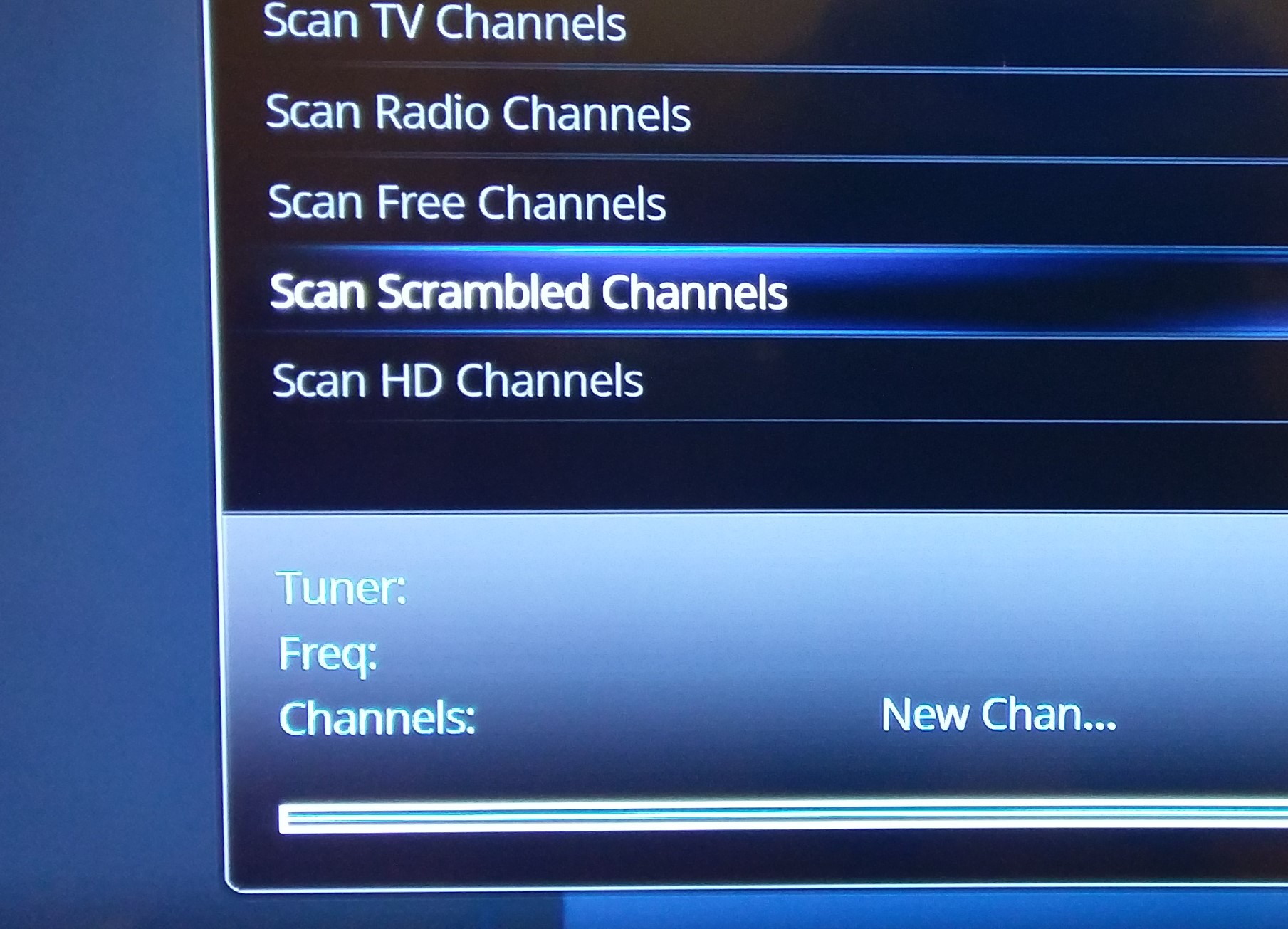

  • Thanks afl1
    I'm trying to setup TVHeadend with the LE repository version.
    The DVB-card is recognized without problem. The problem is to detect the muxes and services. This is my configuration for the Astra 19.2E
    The only detected mux is this
    with this configuration.
    I know that is more a question about TVheadend that about this release, and sorry for this, but I'll appreciate any help. I really need the DVB-S works. Otherwise, I'll must play only with Android. :s
  • You have a wrong 4 port switch config. At first rename your "DVB-S Network" to "Astra 19.2E" and assign it to single switch position corresponding to switch input for Astra LNB (e.g. AB) and clear all other positions. Then go to "Network" tab select "Astra 19.2E" and push Force scan. For more details watch carefully Youtube tutorials.

    Thank you again afl1,
    I configured another setup with DVB-T in a s905 TV Box without problems.
    I've being watching the Youtube tutorials but the TV Headends versions are older, so the settings are differents.
    I've tried your configuration. If I've understood well this is what you recommend
    Unfortunately it does not work either
    In the status tab I see that SNR and Signal Strength is Unknown
    Is this normal?
    Anyone has working a DVB-S setting with this release?

    This is the TVHeadend log
    Edited once, last by Burrunba (April 25, 2017 at 10:30 AM).

    Your antenna is like mine (neighborhood community) multiplexed with DVB-T and DVB-S in the same cable or individual?
    I think the key is in the Unauthorized access message in the TVheadend log
    Anyone knows what can I do to solve it?

    The unauthorized message is coming from your TVHeadend client addon in Kodi trying to access your TVHeadend server (they are two seperate programs). You need to create a user and password for the client in TVH Server and add that username and password in the TVH Client settings.

    Thank you very much.
    Do you know what kind of user I need to create? Is enough with the user that is created with the initial wizard with these rights?
    BTW, I've followed this Youtube tutorial (using LE repositories) to setup the TVHeadend and there is not reference to configure user/password. Is there this configuration in any file?
