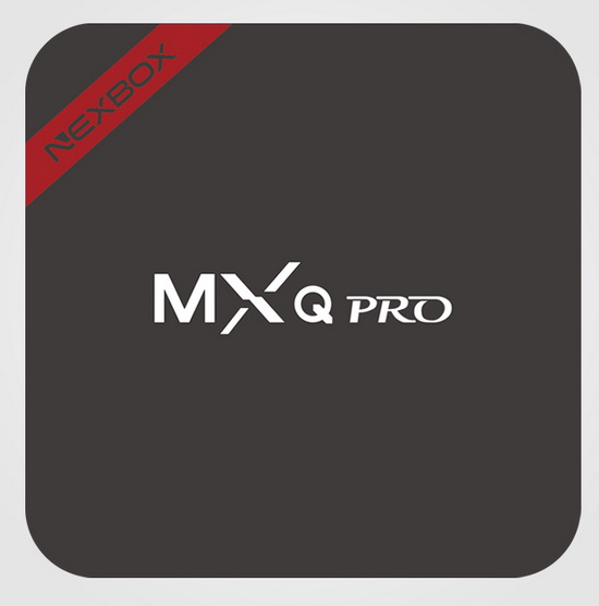

  • Hi all.
    I've a NEXBOX MXQ PRO that I brought last year but I haven't used until now. My box has a sticker "MXQ-S905 1G/8G" / "RTL8189 20160315" on the PCB.
    These cheap boards have a well-known bug in uboot that prevents to power on the box from remote.
    I've installed latest nexbox official firmware "cyx_MXQPro-NEXBOX_8189etv_8g1g_kodi_addons_160603_USB.rar" from Download latest Android Kitkat 4.4.2 stock firmware for Nexbox MXQ Pro TV Box - China Gadgets Reviews
    With this firmware I managed to install libreelec on the NAND storage but the annoying power-on bug persists. This is a bad quality firmware not only for power-on bug, you can't go to recovery using the toothpick method.
    I've found another firmware for "mxq pro 4k" (it adds 4K to the name) dated 02-12-2016 from here:
    FIRMWARE: TV-Box MXQ PRO 4K con SoC S905 (02-12-2016) | AndroidPC.es
    Download firmware link
    This firmware solved the power-on bug!!
    I was excited, because when I use this firm I can power off and even power on from libreelec and the recovery toothpick method worked!!!
    Unfortunately I didn't manage to install properly libreelec to NAND using this firmware. Although "installtointernal" script works fine, I only get a blank screen on reboot. I tried with gxbb_p200_1G_100M.dtb, gxbb_p200_1G_mxq_pro_4k.dtb,gxbb_p200_1G_100M_RealtekWiFi.dtb and gxbb_p201.dtb (this last firm is for a p201 version).
    I did a lot of tests without success. I could use libreelec from SD but not from NAND.
    Then I found an amlogic tool that that allow me to edit images (Amlogic Customization Tool V2.0.8)
    So I extracted "MXQ PRO 4K" image and copied "bootloader.partition", "ddr.usb" and "uboot.usb" from this last to the original nexbox image.
    Then I burnt it using a home-made USB male to male cable to my box and It worked. I could go into recovery using toothpick method. That didn't work with standard NEXBOX firmware.
    I managed to run libreelec fom SD. Power on from remote works well and the most important think is that libreelec installation to NAND worked.
    I've uploaded the uboot modified firmware:
    [cyx_MXQPro-NEXBOX_8189etv_8g1g_kodi_addons_160603_USB_uboot_mod_by_elbuit.img]
    Install it using male-to male USB adapter and then install libreelec.
