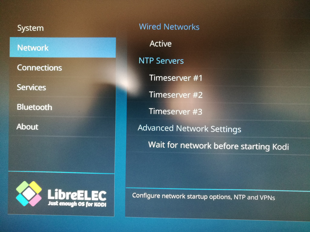

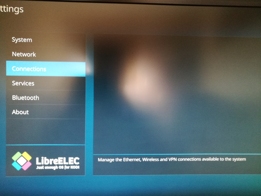

  • Hello, I'm trying to install LibreLEC on my Z83 which contains an Intel Atom x5-Z8350.
    Like it already contains a Windows partition into his flash memory, I've decided to install LibreELEC on a USB flash key (via another USB flash key for the installation).
    The issue is that I have no section for wireless configuration. Is it because I've intstalled LibreELEC on a USH flash key or because of non-support of the hardware (it's written Wifi AP6234 on the product page) ?
    I've send you screens to be sure that I'm looking into the right sections :
    Regards
  • Wireless Networks should be on top of Wired Networks

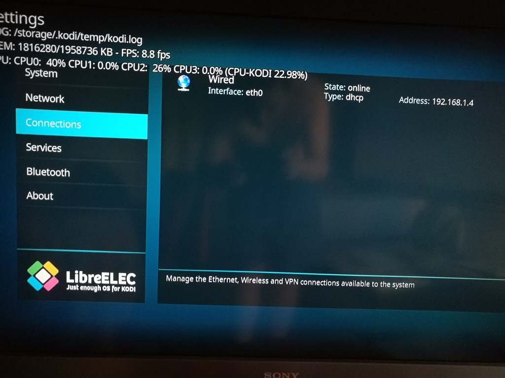

  • Sorry for logs, I'm new with LE. So I send the 2 logs.
    I've tried to connect it to Internet with the Ethernet port and wired connexion seems to work.
    If necessary, I could try to make a partition of 2 Go into the 32 Go flash disk if for example you think that an installation on the disk could make a difference regarding the hardware detection (for example I active bluetooth but it writes me that BT is deactivated when I'm looking my BT controller/gamepad). But I don't know if it's possible to make a dual boot LE/W10 without installing a 3rd distribution like Ubuntu to have Grub (I don't want to brick my Z83 if after installing LE I can't access to a menu for booting)
  • I think your Wifi adapter is no longer supported, did you try an older build?

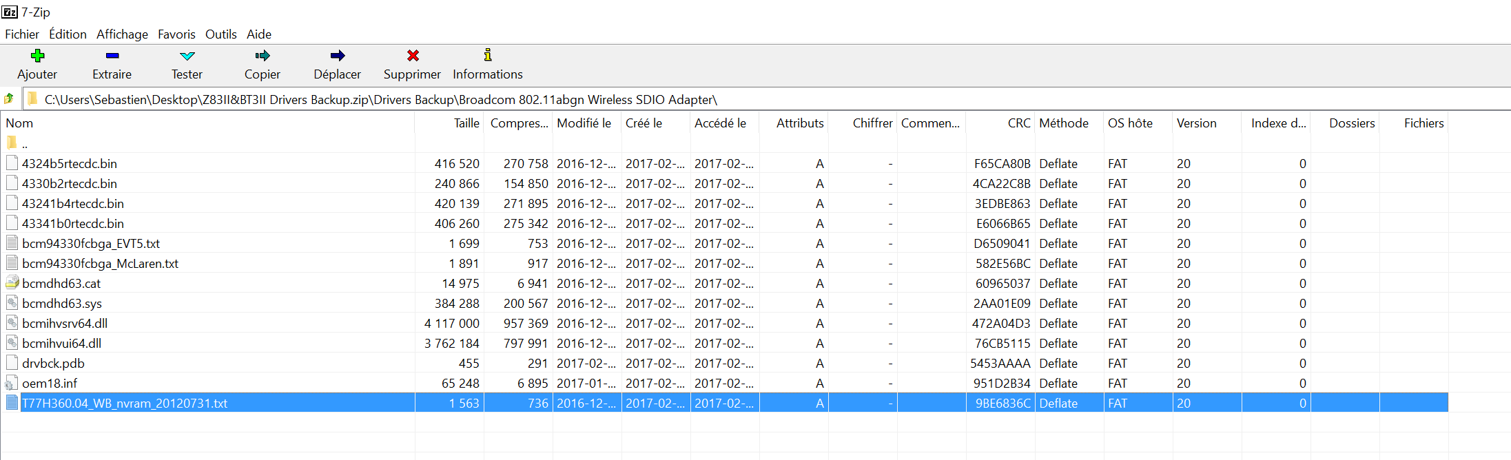

    I retrieve a backup of drivers from manufacter, it's useless for LE isn't it ? Only for Windows ?

    These drivers will be useless sorry.
