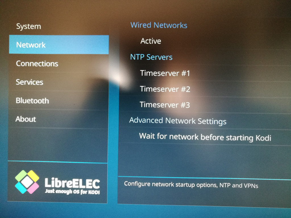

    I think your Wifi adapter is no longer supported, did you try an older build?

    Hello, I'm trying to install LibreLEC on my Z83 which contains an Intel Atom x5-Z8350.
    Like it already contains a Windows partition into his flash memory, I've decided to install LibreELEC on a USB flash key (via another USB flash key for the installation).
    The issue is that I have no section for wireless configuration. Is it because I've intstalled LibreELEC on a USH flash key or because of non-support of the hardware (it's written Wifi AP6234 on the product page) ?
    I've send you screens to be sure that I'm looking into the right sections :
    Regards
