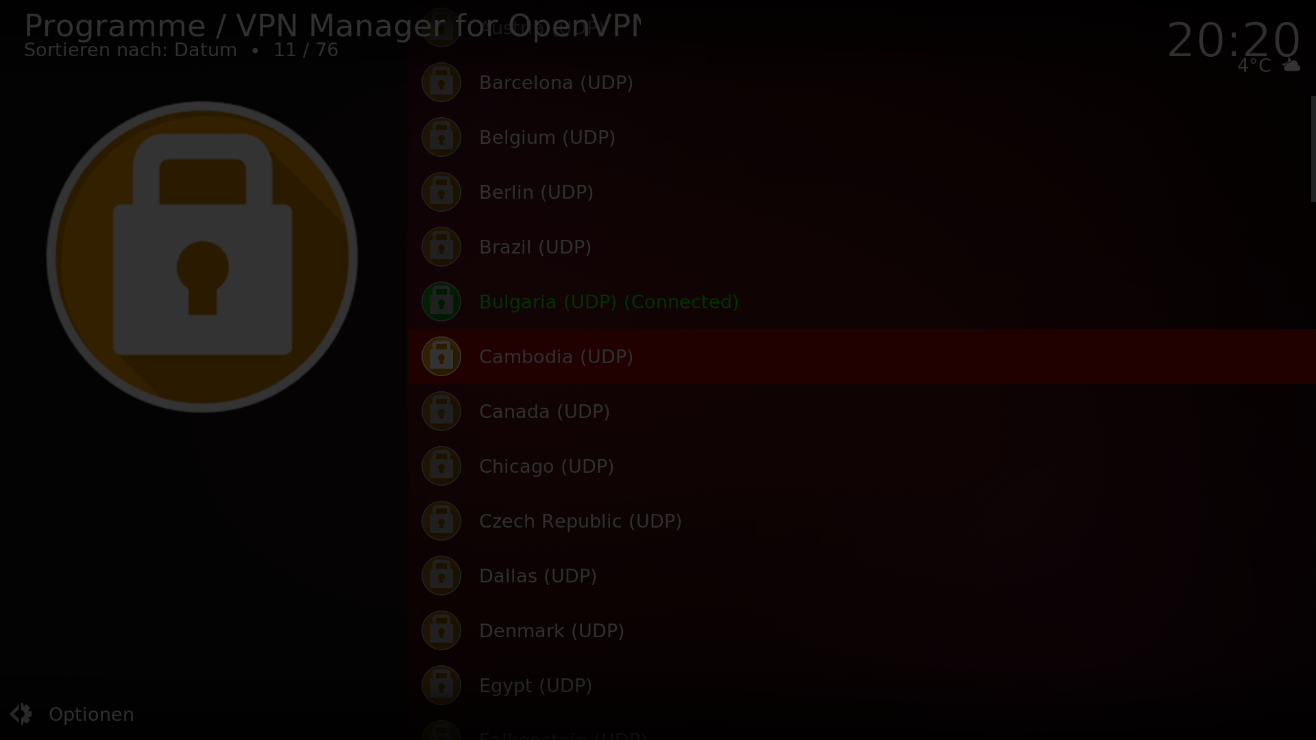

  • no connection is established
    when i do ip check still see my real external ip
    on the picture see connected
    but is not

  • Post a full kodi log with VPN mgr settings/advanced/debug enabled on pastebin
    Please don’t fill the forums with this stuff and don’t edit the log unless you know what I’m looking for
