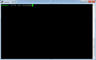

    The .config folder is to 100% in the storage folder. All files and folders with a leading dot are hidden on posix systems. If you wanna see them, you can use ie. "ls -la /storage". For more info rtfm (man ls).
    ok mate thats exactly it,the ones with a dot before arent showing only

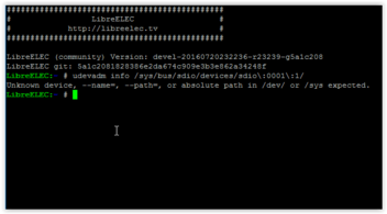

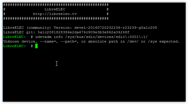

  • Did not work.. please see screenshot
    using putty on win10 machine.
    Hmm. Can you check the path manually? Start with /sys/bus/sdio/devices/ and use the path auto completion (tab). You could also check /sys/bus/sdhc... but I never had one with sdhc yet. If that doesn't work, we need more infos about the wifi chip. You could open the box and check which wifi chip is inside.
