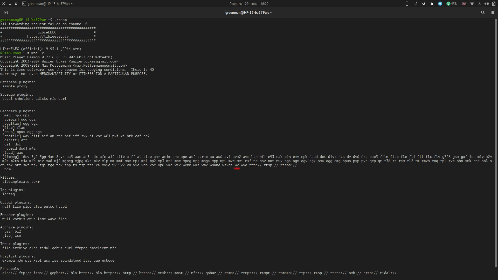

Hello!
I installed LibreElec 9.95.1 and mpd (as service addon) and found that when playing WavPack DSD files with a samplerate of more than 384 kHz, the sound is very interrupted. A search on the Internet did not give anything, the mpd settings also did not bring any result. And then I accidentally looked into:
mpd -V
— and found that it was built without native support for the WavPack format, that is, it decodes it using ffmpeg. And ffmpeg DOES NOT RECOGNIZE DSD compressed with WavPack.
In…
