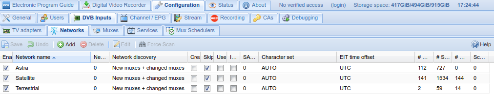

    2. Different scan results: Fewer muxes and fewer services for the same Satellite network (Astra 28.2E), with some (14) remaining forever in the scan queue compared to scanning with a Hauppauge PCI board.
    Here's my original PVR scan results (Astra is DVB-S2 via Digibit Twin; Satellite is via Hauppauge PCI board)

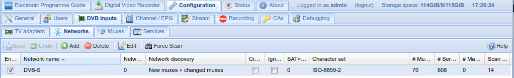

    and here's the result with the Digibit Twin used with my Pi 3
