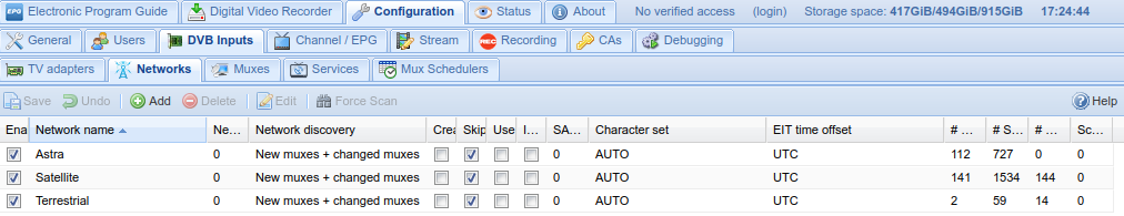

    This is an interesting and, I think, a good idea -- as a someone who uses LibreElec with TVHeadend exclusively as a PVR.
    Having just updated to 11.04 and installed a larger SSD I logged in to scan the forum for ideas to improve my PVR setup. I'm potentially interested in new hardware too as as my PVR box is old and I am sure I could exchange it for something using a fraction of power, but I haven't researched this yet. First, I'd like to optimise my software setup and then look at new hardware.
    Software
    I live in Ireland and have access to Irish and UK terrestrial and satellite TV, and potentially to IPTV (haven't used so far). First requirement is integrating EPG data from different sources. This works fine but it is tedious to set up in an attractive way -- principally by filtering out all the channels one doesn't care to have included (approximately 90% of over 1,000 in my case).
    My other PVR, a ZGemma HS7 box in the bedroom, running OpenVix software -- essentially an updated Enigma2 box -- provides many more bouquets than simply Terrestrial and Satellite. I use this mainly to be able to make more simultaneous recordings (a very occasional need).
    I tried, briefly, to make the EPG be in sync, presentationally, with that on my LibreElec HTPC. It wasn't worth the trouble and I gave up. Software updates tended to mess things up. One thing that the ZGemma does seem to do, however, is handle channels moving to different frequencies with a bit less effort than TVHeadend. Occasionally there are odd minor discrepancies between what the TV, the HTPC and the ZGemma can decode from the same inputs (dish and UVHF aerial), but... if it was possible I would like to be able, going beyond the steps outlined envisaged in the setup wizard to import selected bouquets from the ZGemma or, more realistically, some other source

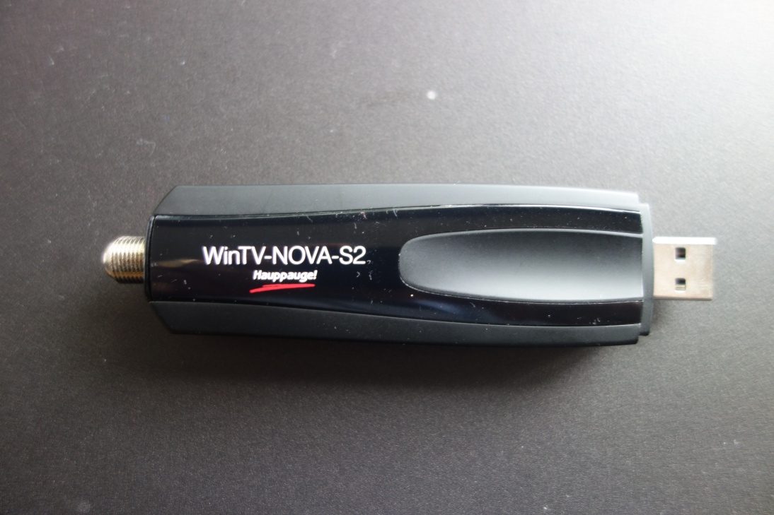

    • It has an internal Hauppauge DVB-S2 tuner card (also a USB DVB-T externally)

    I believe there are a good number of mini PCs for sale online on places like AliExpress which i could use as a more energy efficient PVR and I will be interested to see if any are popular for this, and which would justify retiring the old HTPC and internal tuner (I can reuse the SSD and DVB-T tuner).
    Finally
    I might consider other ideas besides updating my existing STB arrangements, such as putting a larger mini PC with multiple tuners in the attic and using raspberry pi clients in the rooms with TVs (2) and scrapping the existing PVR boxes (and making the coax cables to them redundant; I have Ethernet wiring in place). Happy to have any suggestions for improvement to my current setup.
    In any case, I'd like to thank the developers and all who have contributed to LibreElec for enabling me to run a fine PVR at very little cost over the years, and wish you all a Merry Christmas and all the best for 2024.

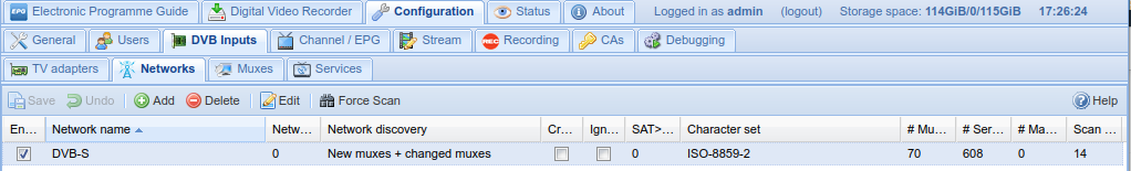

    Yes, I can see the tuners at IP:9981 and they're working ok. The TVH server and client are on the same box. The server is set up with 3 usernames, admin, me, and *, with passwords for the first two, for administration, EPG browsing, and client interaction respectively. The 3rd is a default entry the first two are wizard created on first logging in to the web UI.
    The client needs the IP of the server and 127.0.0.1 worked previously and I don't think hardcoding it to a 192.168.1.x will resolve (I've never known a machine not know where 127.0.0.1 is).
    Update:
    OK. Problem solved. Somewhere the default user * was deleted, perhaps when I added a user (myself) and I hadn't entered the username and password in the client.
    I'm using LibreElec with TVHeadend as a dedicatd PVR. Did a fresh install of v9.3.2, using Realtek RTL2832 USB tuner for DVB-T and a Hauppauge Win-Nova-T for DVB-S. Initially it worked ok but after a couple of days I got the message shown in the Subject line when selecting TV or Guide.
    I have searched without success for a solution.
