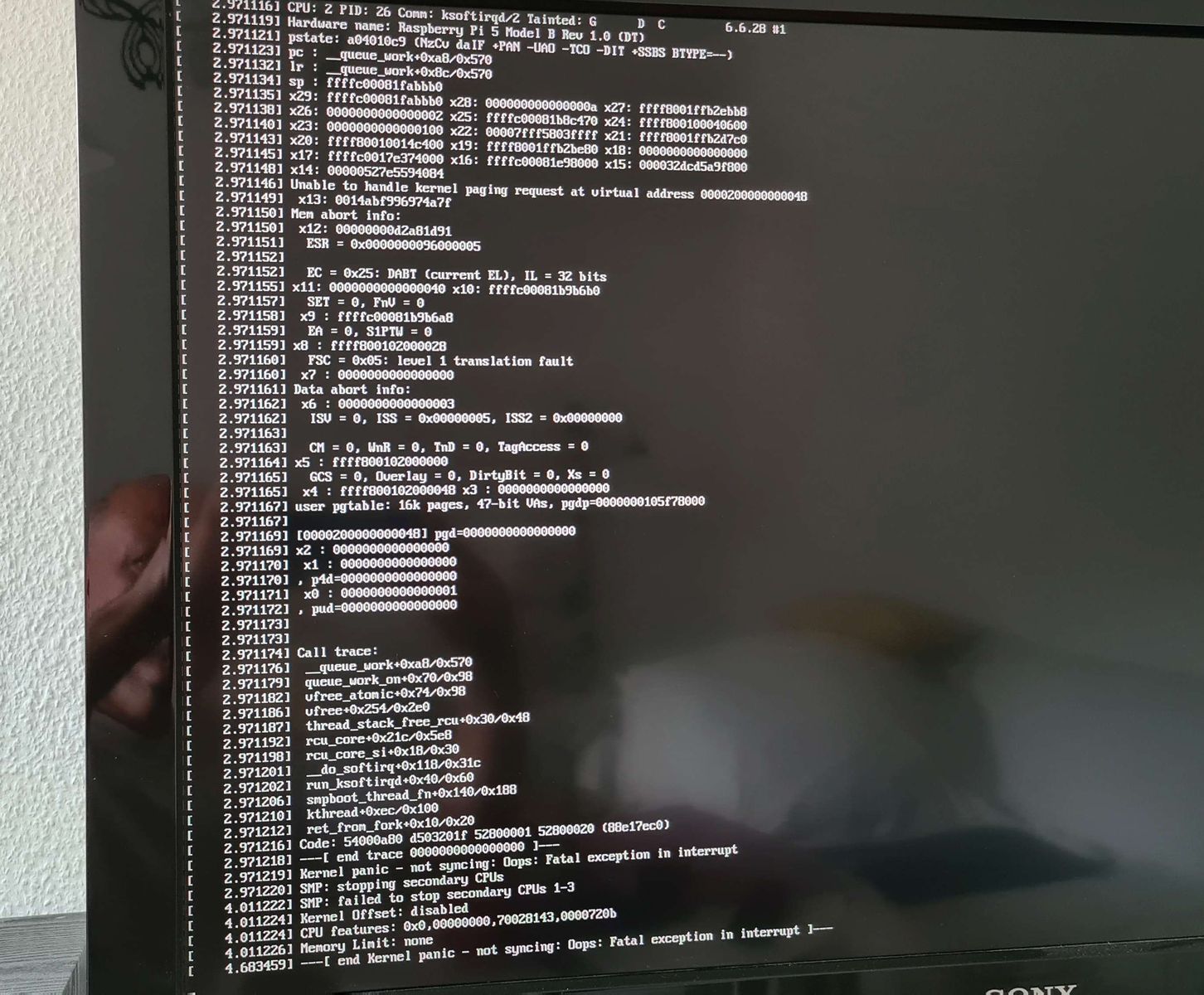

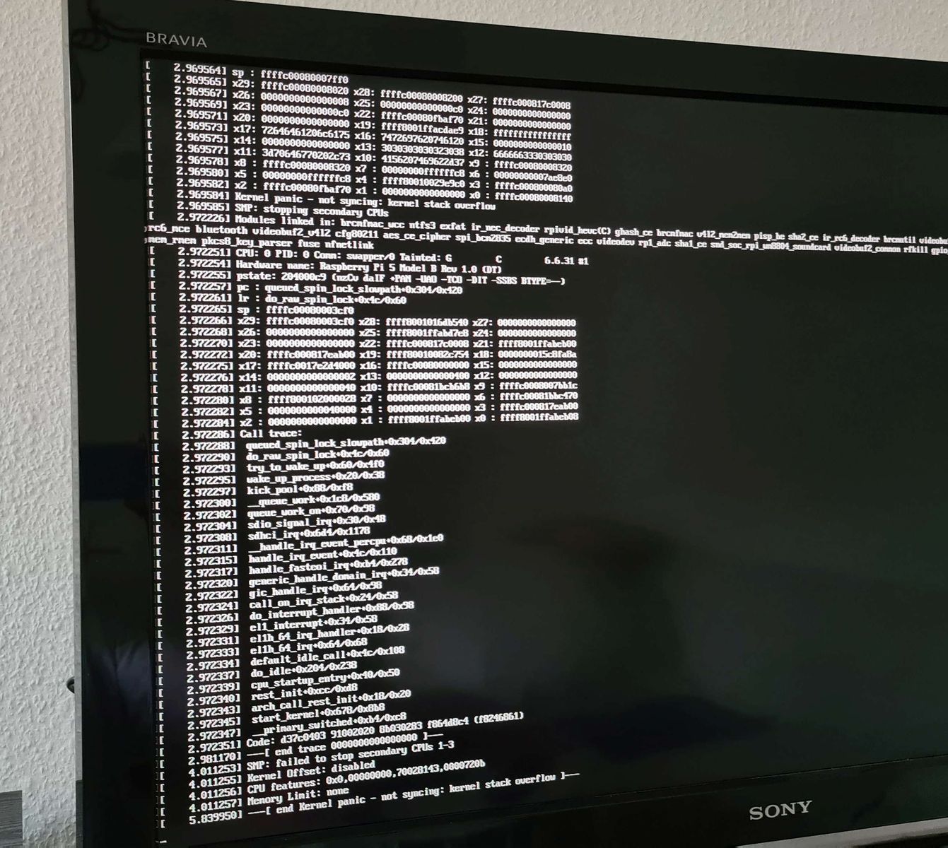

With LibreElec I'm stuck on a nightly build of 12.0 beta published at the end of February because of the exact problem about NTFS on USB drives described in this thread. Until 5-6 weeks ago I used to try sometimes to upgrade to a 13.0 fresh nightly build, but nothing to do, everything crashed first or after.
Has the situation got better now? I saw a fresh update with a new linux kernel with ntfs driver updated in the release notes...

Fantastic, chewitt: with this release no more crashes after using the drives with the notebook to write something on.
Only one thing: without a scandisk /f from Windows, it seems that the drive is not recognized anymore, as usual from when the new NTFS driver has been adopted. This was expected, am I right?
The patch resolves a specific issue with the 16K page size in the RPi kernel. It doesn't change any of the other stupidity that is seen with NTFS devices. If the filesystem is marked dirty for any reason you still need to clear that from Windows.
By the way, I too was getting crashes in LE 12 on my Pi 5 even after safely unmounting in Windows.
